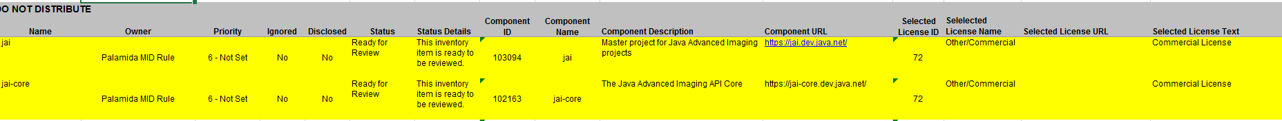

Dear Team,
We are using open source geoserver but when we ran the Palamida scan we find two components for which it’s showing license as a “commercial”. Can you please help us in this context?
Looking forward to hearing from you!
