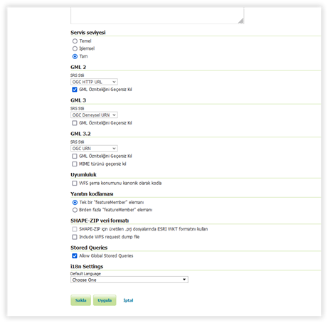

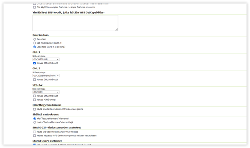

Great, that looks perfect.

Thanks to the nice new feature of Andrea:
In Finnish:
And in Turkish:
