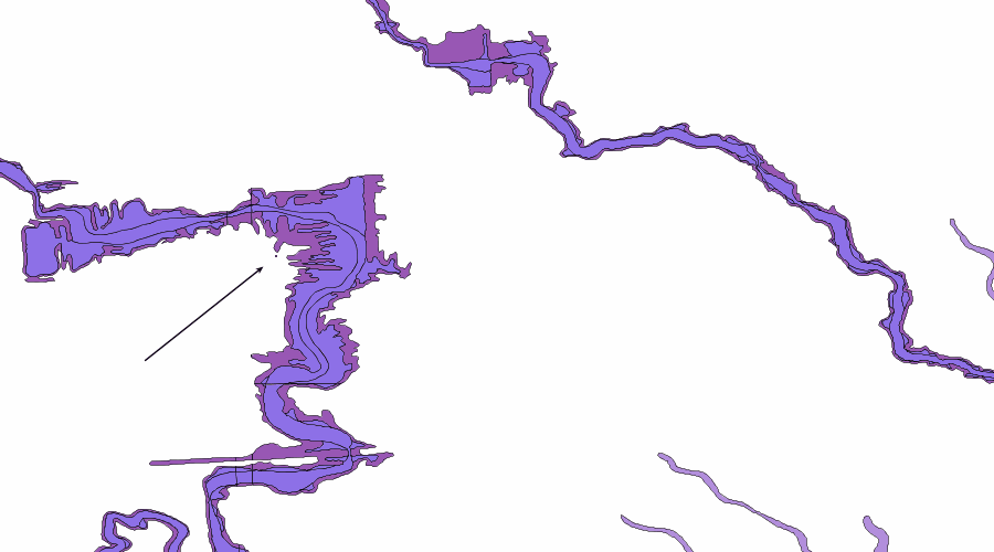

Hi Charles,
I've got your data and style and applied it. The above request
does not return any data because there is none drawn by the associated
GetMap request in that point.
I've attached the image generated by the GetMap request, and drawn
a little red dot at &X=250&Y=232. As you can see it's close to a
rendered area, but does not touch it.
Older versions of GeoServer were not able to take into consideration
the filters included in the SLD style and just returned whatever
was there (that is, assuming no filtering at all). That was not
compliant to the WMS spec, GFI must return only information
about what was drawn by the GetMap.
If you still want your GetFeatureInfo to return even features that
are not drawn set, in your GetFeatureInfo, the style to
"polygon" or whatever other style that draws everything.

Andrea,
Thanks for looking at this it's had me puzzled for a few days now. If I
understand you correctly the GFI request below was generated by clicking
on an area that does not have a feature defined in the style. I have
modified the style a bit to include a few missing features and it seems
to have helped.
I am a bit concerned about the location you marked for the feature
request. We are unable to determine the exact X/Y location from the GFI
request. If you would please, as a test for us, can you mark the
location of these three GFI request as you did with the last PNG you
sent? We are thinking we may have another issues not related to the
missing attributes in the style.

Hi Charles,
I've got your data and style and applied it. The above request does
not
return any data because there is none drawn by the associated GetMap
I've attached the image generated by the GetMap request, and drawn a
rendered
the
filters included in the SLD style and just returned whatever was there
(that is, assuming no filtering at all). That was not compliant to the
WMS spec, GFI must return only information about what was drawn by the
GetMap.
If you still want your GetFeatureInfo to return even features that are
not drawn set, in your GetFeatureInfo, the style to "polygon" or

Charles E. Deaton ha scritto:
Andrea,
to have helped.
It's actually pretty easy. Get any image manipulation program (I used
Gimp) and look at the x/y coordinates displayed in the toolbar.
As in all computer graphics applications, x grows from left to right,
y from top to bottom.
Cheers
Andrea
Andrea Aime
OpenGeo - http://opengeo.org
Expert service straight from the developers.
