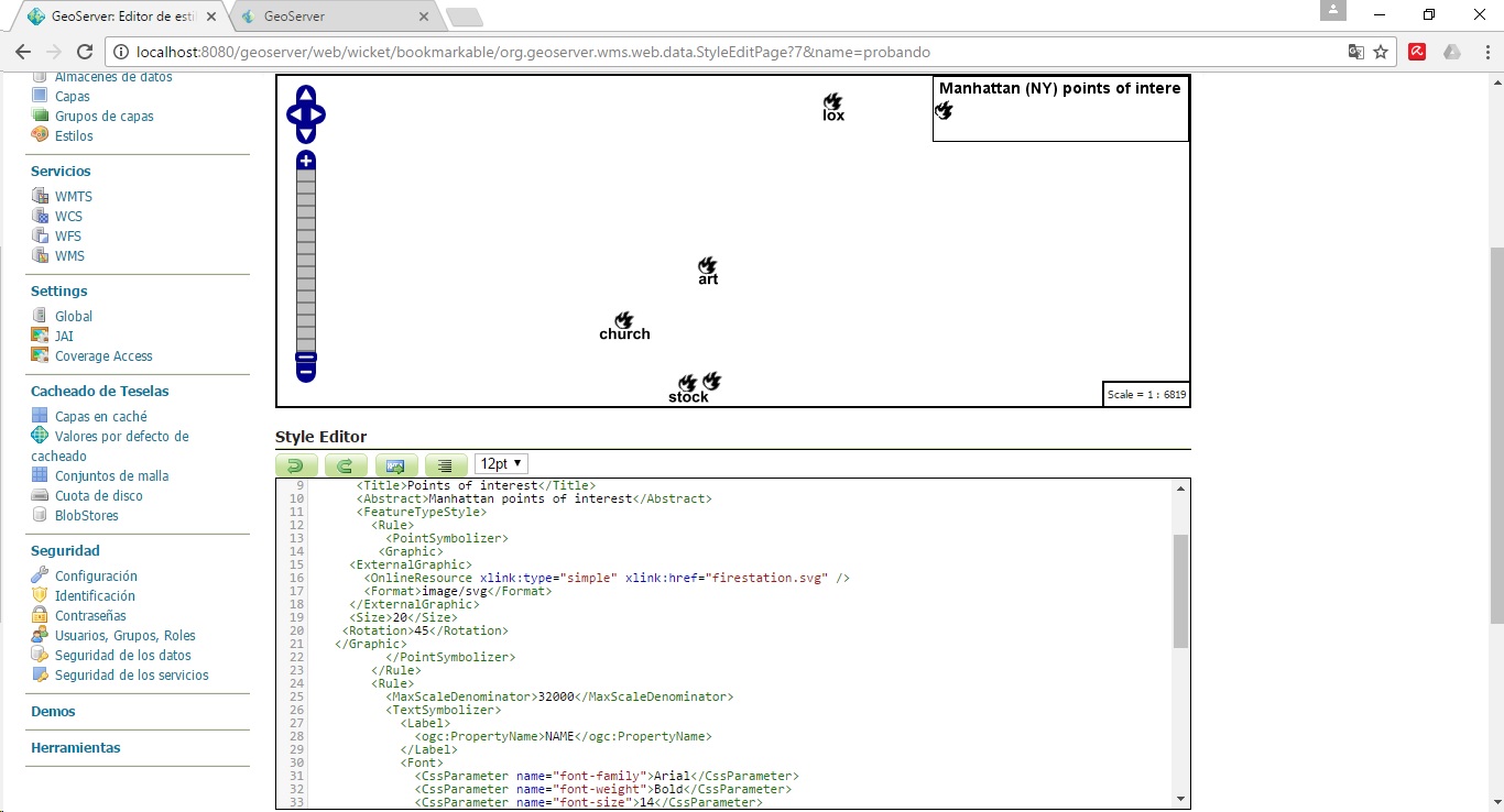

Hi Andrea, thanks for your help. I attached the svg icon (I designed with svg-edit online editor and replaced manually the param lines) and the portion of the sld that is parametrized. The rectangle in the image is shown but it is totally dark.
<PointSymbolizer uom=“http://www.opengeospatial.org/se/units/metre”>
image/svg
20
ogc:PropertyNamerotation</ogc:PropertyName>
Thanks!!

Hi Andrea, I tried as well with the firestation icon from QGIS 2.14 and I am experiencing the same problem while modifying the Manhattan POI layer from geoserver and styling it with the svg that I attach. I attached the icon and two screenshots from layer preview showing the icon without fill param and with fill param. With fill param the icon is not shown. I don´t know if i am doing something wrong or misunderstanding something.
Thanks for your help.

Hi Joaquin,
I’ve just tried and got the same results as you. No idea why it’s happening though, the code
to do parametrization has automated tests using exactly the firestation symbol and they are working…
Can you open a ticket at https://osgeo-org.atlassian.net/projects/GEOS/summary so that we don’t forget
to look into it?

Thanks Andrea, I have just opened it.

Ah, in the meantime I found out what is not working, it’s relative paths… if I point to the SVG
using an absolute path then color replacement works. e.g.:
image/svg
20
Thanks!!

Thanks Andrea. I never thought it could be that because the icon was shown without params.
I´ll try it meanwhile with absolute path because it´s a very useful feature for me.
