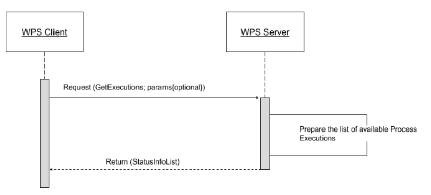

I would like here to ask your opinion about a possible extension/improvement of the GeoServer WPS Service.
The main goal of this proposal is to allow a client to recognize the list of WPS Executions through a simple request to a WPS Operation. What we would like to achieve would be something similar to this:
The client makes a simple “GetExecutions” request to the WPS Server, in order to get back an XML document containing the list of current Execution Statuses.
Ideally should be possible also to filter the “GetExecutions” request along with simple parameters, in order to refine the output and get back only the executions status we are looking for.
Adding a bit more to this, if AUTHORIZATION headers are sent along with the “GetExecutions” request, the WPS Server should be able, if a security subsystem is available and enable on the latter, of provide also the list of eventually private/protected resources to the client itself.
Part of this proposal is also to review and improve the “lineage” option of the WPS service, allowing a client to retrieve the Execute Inputs values provided to the process Identifier.
Thoughts?

Hi Alessio,
a few questions to help clarify your proposal:
  • Right now the list of executions is visible only to the administrator via the GUI. How does this request work authorization wise? Anyone can see all executions? Or only the ones he started as an authenticated user?
  • What info gets returned? Same as in the GUI right now? More?
  • How does one filter the list of returned values?

Hello Andrea,
thanks for your questions. Let me try to clarify a bit more what we have in mind right now.
Executions List
At a first glance I was thinking to the possibility of having some “public” executions, somehow, but digging a bit more on the proposal this does not make much sense.
The new operation should return only the list of available Executions the logged in user has started, except in the case it is an Administrator. In that case he will be able to get the whole list.
StatusInfo Response
Yes, roughly it should return what we see on the GUI, possibly with a bit more information (when/if available) as detailed in the table below

GetExecutions Request
In order to filter and refine the Request, I was wondering about a set of simple Request parameters as depicted in the diagram below
which are better detailed in the table here below

Hi Alessio,
thanks for the useful feedback. Notes inline.
On Thu, Jul 12, 2018 at 12:30 PM, Alessio Fabiani <alessio.fabiani@anonymised.com> wrote:
Executions List
Yep, makes sense.

How will you guess the estimated completion? Elapsed time vs percentage complete?
In general GeoServer has a hard time with the percentage complete calculation, as the overall process execution
goes through 3 phases:
  • Parsing the inputs and turning them into Java classes suitable for process consumption. This part is given a fixed percentage. If all the inputs are simple (string, number, dates) the % is small, if the inputs are complexes (have to be parsed and may be large or retrieved from remote) I think it’s something like 30%, but you’d have to check in the code.
  • Actual execution, consuming java objects and producing other java objects. This is all over the place, some processes are streaming and give you back a GridCoverage2D backed by a deferred execution or a FeatureCollection that will compute the results when traversed (both to avoid storing a ton of memory), others have no progress support at all, only a subset are actually doing the computation during execute and with reasonable progress support.

Hi Andrea,
not sure this is useful for our real use case. In our case we can send this estimate from the backend. In particular we are using the “wps-remote” plugin which completely relies on backend processes decoupled by an XMPP layer.
Nevertheless, my intention is to include this parameter on the proposal, even though this will be optional, since it is possible that some Processes instances in the future might use it and provide really useful information to the client.
Executions List
Yep, makes sense.
StatusInfo Response
