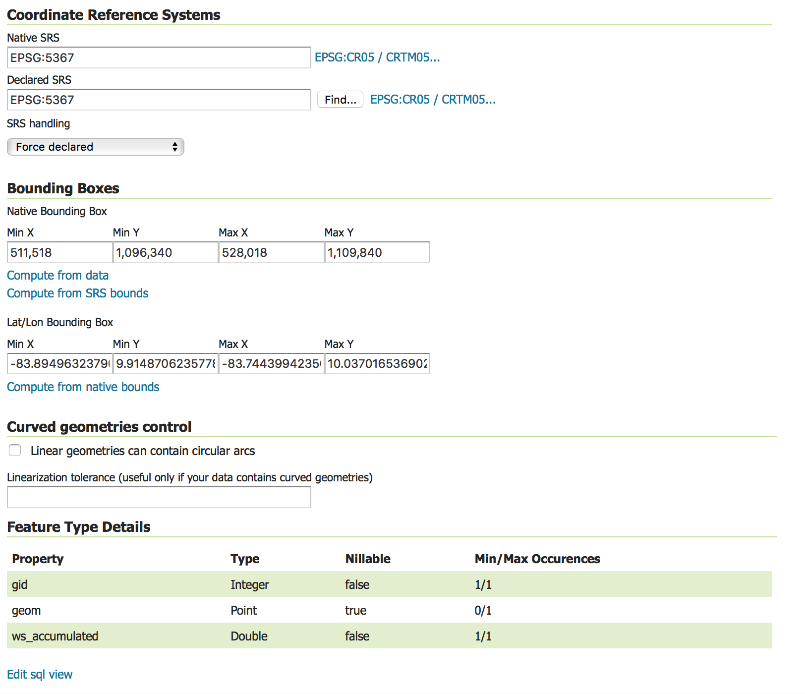

I am new to GeoServer, and after setting up an SQL view, sending data to the parameters produces no effect.
My setting is as follows:

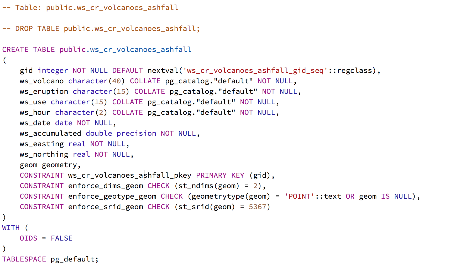

  1. A PostGIS database with the following table definition (CRTM05, EPSG:5367). The database contains only Point objects with a series of attributes.
  1. An installation of GeoServer ver 2.11.2.
  2. An SQL view as follows:
SQL
SELECT gid, geom, ws_accumulated
FROM ws_cr_volcanoes_ashfall
WHERE
ws_volcano=%VOLCANO%
AND ws_eruption=%ERUPTION%
AND ws_use=%USE%
AND ws_date=%DATE%
AND ws_hour=%HOUR%
  • With the following parametrization and validation:
With the following attribute settings:
My service is setup at:
http://gser.reciem.org:8080/geoserver/reciem/ows?service=WFS&version=1.0.0&request=GetFeature&typeName=reciem:cs_volcano_timeslab&outputFormat=application%2Fjson
What may my mistake be?

Hi, these url's are working?
gser.reciem.org:8080/geoserver/reciem/ows?service=WFS&version=1.0.0&request=GetFeature&typeName=reciem:cs_volcano_timeslab&outputFormat=application/json&viewparams=use:'regular';hour:'02'
{"type":"FeatureCollection","totalFeatures":539....
gser.reciem.org:8080/geoserver/reciem/ows?service=WFS&version=1.0.0&request=GetFeature&typeName=reciem:cs_volcano_timeslab&outputFormat=application/json&viewparams=use:'regular';hour:'03'
{"type":"FeatureCollection","totalFeatures":546,"features":...
note the different number of features.
I had to put the values in quotes, not sure if that is always mandatory
