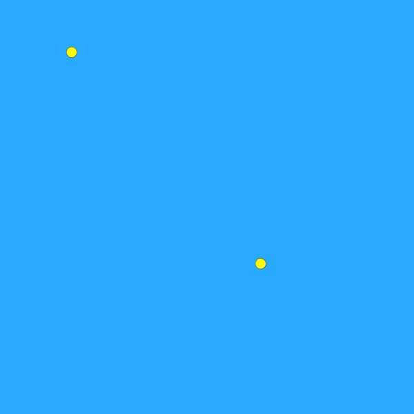

Miles Jordan ha scritto:
I'm afraid the problem does still exist. I tried the 071007 build.
Here's the request:
http://YOUR-GEOSERVER-HOST/geoserver/wms?bgcolor=0xf2AAAFF&bbox=-2661827
8078423585,-2489793.885787334,2750918.460493497,2321607.9999959785&SLD=
http://milesjordan.com/sld/geos-test.sld&Format=image/png&request=GetMap
&width=600&height=600&SRS=EPSG:3031
Soo... I've found quite a few issues, and I think I fixed them all,
but only on trunk, on 1.5.x I could to make 3031 work (if you have any
magic recipe of your own, please share, it's probably just an issue
of setting up the proper wkt definition :)).
One thing, the srsName you provided in the SLD is invalid, the
correct form is srsName="srsName="http://www.opengis.net/gml/srs/epsg.xml#4326"
If you try out tomorrow's trunk nightly build you should get the
same image as the one attached with the following request (fix
the sld url to point to your own):
http://localhost:8080/geoserver/wms?bgcolor=0xf2AAAFF&bbox=-2761827.8078423585,-2589793.885787334,2850918.460493497,2421607.9999959785&SLD=http://localhost:8080/geoserver/www/test.sld&Format=image/png&request=GetMap&width=600&height=600&SRS=EPSG:3031
Cheers
