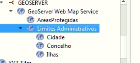

Read about layer groups https://docs.geoserver.org/stable/en/user/data/webadmin/layergroups.html. The Container tree option is probably what you want.

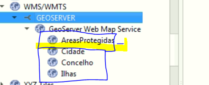

Hi group,
How can I present the layers with a title separating them?
