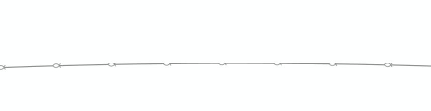

Hi,
I have a line layer served out with GeoServer. When I add the line as a WMS in Quantum GIS or ArcMap, I notice that the line is cut in half (see attachment. Pay attention to the fish symbol in the middle of the line). The line is located right at the maximum extent of the layer bounding box. How does this happen and how do I fix this issue? My guess is that the line, with its styling, is so thick that it extends beyond the bounding box of the layer. So probably some kind of drawing margin might help but I can't find similar setting in GeoServer.
