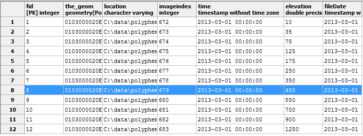

Finally, these are the contents of the PostSQL table "CAT_GPML":
"fid"|"the_geom"|"location"|"time"|"z"|"fileDate"
1|"010300002019D40E000100000005000000E4384E6D668049C1922469969F3222C1E4384E6D668049C126499A5AC3464E41E438CEA5EA1A454126499A5AC3464E41E438CEA5EA1A4541922469969F3222C1E4384E6D668049C1922469969F3222C1"|"/d1/nnew/GeoServer/8089_server/test_nc_mosaic_orig_height_xml/lambert_sample_20160318T100000000Z_l_0064800.nc"|"2016-03-18
10:00:00"|0.03|"2016-03-18 10:00:00"
2|"010300002019D40E000100000005000000E4384E6D668049C1922469969F3222C1E4384E6D668049C126499A5AC3464E41E438CEA5EA1A454126499A5AC3464E41E438CEA5EA1A4541922469969F3222C1E4384E6D668049C1922469969F3222C1"|"/d1/nnew/GeoServer/8089_server/test_nc_mosaic_orig_height_xml/lambert_sample_20160318T100000000Z_l_0064800.nc"|"2016-03-18
10:00:00"|0.304|"2016-03-18 10:00:00"
3|"010300002019D40E000100000005000000E4384E6D668049C1922469969F3222C1E4384E6D668049C126499A5AC3464E41E438CEA5EA1A454126499A5AC3464E41E438CEA5EA1A4541922469969F3222C1E4384E6D668049C1922469969F3222C1"|"/d1/nnew/GeoServer/8089_server/test_nc_mosaic_orig_height_xml/lambert_sample_20160318T100000000Z_l_0064800.nc"|"2016-03-18
10:00:00"|0.609|"2016-03-18 10:00:00"
4|"010300002019D40E000100000005000000E4384E6D668049C1922469969F3222C1E4384E6D668049C126499A5AC3464E41E438CEA5EA1A454126499A5AC3464E41E438CEA5EA1A4541922469969F3222C1E4384E6D668049C1922469969F3222C1"|"/d1/nnew/GeoServer/8089_server/test_nc_mosaic_orig_height_xml/lambert_sample_20160318T100000000Z_l_0064800.nc"|"2016-03-18
10:00:00"|0.914|"2016-03-18 10:00:00"
5|"010300002019D40E000100000005000000E4384E6D668049C1922469969F3222C1E4384E6D668049C126499A5AC3464E41E438CEA5EA1A454126499A5AC3464E41E438CEA5EA1A4541922469969F3222C1E4384E6D668049C1922469969F3222C1"|"/d1/nnew/GeoServer/8089_server/test_nc_mosaic_orig_height_xml/lambert_sample_20160318T100000000Z_l_0064800.nc"|"2016-03-18
10:00:00"|1.219|"2016-03-18 10:00:00"
6|"010300002019D40E000100000005000000E4384E6D668049C1922469969F3222C1E4384E6D668049C126499A5AC3464E41E438CEA5EA1A454126499A5AC3464E41E438CEA5EA1A4541922469969F3222C1E4384E6D668049C1922469969F3222C1"|"/d1/nnew/GeoServer/8089_server/test_nc_mosaic_orig_height_xml/lambert_sample_20160318T100000000Z_l_0064800.nc"|"2016-03-18
10:00:00"|1.524|"2016-03-18 10:00:00"
7|"010300002019D40E000100000005000000E4384E6D668049C1922469969F3222C1E4384E6D668049C126499A5AC3464E41E438CEA5EA1A454126499A5AC3464E41E438CEA5EA1A4541922469969F3222C1E4384E6D668049C1922469969F3222C1"|"/d1/nnew/GeoServer/8089_server/test_nc_mosaic_orig_height_xml/lambert_sample_20160318T100000000Z_l_0064800.nc"|"2016-03-18
10:00:00"|1.828|"2016-03-18 10:00:00"
8|"010300002019D40E000100000005000000E4384E6D668049C1922469969F3222C1E4384E6D668049C126499A5AC3464E41E438CEA5EA1A454126499A5AC3464E41E438CEA5EA1A4541922469969F3222C1E4384E6D668049C1922469969F3222C1"|"/d1/nnew/GeoServer/8089_server/test_nc_mosaic_orig_height_xml/lambert_sample_20160318T100000000Z_l_0064800.nc"|"2016-03-18
10:00:00"|2.133|"2016-03-18 10:00:00"
9|"010300002019D40E000100000005000000E4384E6D668049C1922469969F3222C1E4384E6D668049C126499A5AC3464E41E438CEA5EA1A454126499A5AC3464E41E438CEA5EA1A4541922469969F3222C1E4384E6D668049C1922469969F3222C1"|"/d1/nnew/GeoServer/8089_server/test_nc_mosaic_orig_height_xml/lambert_sample_20160318T100000000Z_l_0064800.nc"|"2016-03-18
10:00:00"|2.438|"2016-03-18 10:00:00"
10|"010300002019D40E000100000005000000E4384E6D668049C1922469969F3222C1E4384E6D668049C126499A5AC3464E41E438CEA5EA1A454126499A5AC3464E41E438CEA5EA1A4541922469969F3222C1E4384E6D668049C1922469969F3222C1"|"/d1/nnew/GeoServer/8089_server/test_nc_mosaic_orig_height_xml/lambert_sample_20160318T100000000Z_l_0064800.nc"|"2016-03-18
10:00:00"|2.743|"2016-03-18 10:00:00"
11|"010300002019D40E000100000005000000E4384E6D668049C1922469969F3222C1E4384E6D668049C126499A5AC3464E41E438CEA5EA1A454126499A5AC3464E41E438CEA5EA1A4541922469969F3222C1E4384E6D668049C1922469969F3222C1"|"/d1/nnew/GeoServer/8089_server/test_nc_mosaic_orig_height_xml/lambert_sample_20160318T100000000Z_l_0064800.nc"|"2016-03-18
10:00:00"|3.048|"2016-03-18 10:00:00"
12|"010300002019D40E000100000005000000E4384E6D668049C1922469969F3222C1E4384E6D668049C126499A5AC3464E41E438CEA5EA1A454126499A5AC3464E41E438CEA5EA1A4541922469969F3222C1E4384E6D668049C1922469969F3222C1"|"/d1/nnew/GeoServer/8089_server/test_nc_mosaic_orig_height_xml/lambert_sample_20160318T100000000Z_l_0064800.nc"|"2016-03-18
10:00:00"|3.352|"2016-03-18 10:00:00"
13|"010300002019D40E000100000005000000E4384E6D668049C1922469969F3222C1E4384E6D668049C126499A5AC3464E41E438CEA5EA1A454126499A5AC3464E41E438CEA5EA1A4541922469969F3222C1E4384E6D668049C1922469969F3222C1"|"/d1/nnew/GeoServer/8089_server/test_nc_mosaic_orig_height_xml/lambert_sample_20160318T100000000Z_l_0064800.nc"|"2016-03-18
10:00:00"|3.657|"2016-03-18 10:00:00"
14|"010300002019D40E000100000005000000E4384E6D668049C1922469969F3222C1E4384E6D668049C126499A5AC3464E41E438CEA5EA1A454126499A5AC3464E41E438CEA5EA1A4541922469969F3222C1E4384E6D668049C1922469969F3222C1"|"/d1/nnew/GeoServer/8089_server/test_nc_mosaic_orig_height_xml/lambert_sample_20160318T100000000Z_l_0064800.nc"|"2016-03-18
10:00:00"|3.962|"2016-03-18 10:00:00"
15|"010300002019D40E000100000005000000E4384E6D668049C1922469969F3222C1E4384E6D668049C126499A5AC3464E41E438CEA5EA1A454126499A5AC3464E41E438CEA5EA1A4541922469969F3222C1E4384E6D668049C1922469969F3222C1"|"/d1/nnew/GeoServer/8089_server/test_nc_mosaic_orig_height_xml/lambert_sample_20160318T100000000Z_l_0064800.nc"|"2016-03-18
10:00:00"|4.267|"2016-03-18 10:00:00"
16|"010300002019D40E000100000005000000E4384E6D668049C1922469969F3222C1E4384E6D668049C126499A5AC3464E41E438CEA5EA1A454126499A5AC3464E41E438CEA5EA1A4541922469969F3222C1E4384E6D668049C1922469969F3222C1"|"/d1/nnew/GeoServer/8089_server/test_nc_mosaic_orig_height_xml/lambert_sample_20160318T100000000Z_l_0064800.nc"|"2016-03-18
10:00:00"|4.572|"2016-03-18 10:00:00"
17|"010300002019D40E000100000005000000E4384E6D668049C1922469969F3222C1E4384E6D668049C126499A5AC3464E41E438CEA5EA1A454126499A5AC3464E41E438CEA5EA1A4541922469969F3222C1E4384E6D668049C1922469969F3222C1"|"/d1/nnew/GeoServer/8089_server/test_nc_mosaic_orig_height_xml/lambert_sample_20160318T100000000Z_l_0064800.nc"|"2016-03-18
10:00:00"|4.876|"2016-03-18 10:00:00"
18|"010300002019D40E000100000005000000E4384E6D668049C1922469969F3222C1E4384E6D668049C126499A5AC3464E41E438CEA5EA1A454126499A5AC3464E41E438CEA5EA1A4541922469969F3222C1E4384E6D668049C1922469969F3222C1"|"/d1/nnew/GeoServer/8089_server/test_nc_mosaic_orig_height_xml/lambert_sample_20160318T100000000Z_l_0064800.nc"|"2016-03-18
10:00:00"|5.181|"2016-03-18 10:00:00"
19|"010300002019D40E000100000005000000E4384E6D668049C1922469969F3222C1E4384E6D668049C126499A5AC3464E41E438CEA5EA1A454126499A5AC3464E41E438CEA5EA1A4541922469969F3222C1E4384E6D668049C1922469969F3222C1"|"/d1/nnew/GeoServer/8089_server/test_nc_mosaic_orig_height_xml/lambert_sample_20160318T100000000Z_l_0064800.nc"|"2016-03-18
10:00:00"|5.486|"2016-03-18 10:00:00"
20|"010300002019D40E000100000005000000E4384E6D668049C1922469969F3222C1E4384E6D668049C126499A5AC3464E41E438CEA5EA1A454126499A5AC3464E41E438CEA5EA1A4541922469969F3222C1E4384E6D668049C1922469969F3222C1"|"/d1/nnew/GeoServer/8089_server/test_nc_mosaic_orig_height_xml/lambert_sample_20160318T100000000Z_l_0064800.nc"|"2016-03-18
10:00:00"|5.791|"2016-03-18 10:00:00"
21|"010300002019D40E000100000005000000E4384E6D668049C1922469969F3222C1E4384E6D668049C126499A5AC3464E41E438CEA5EA1A454126499A5AC3464E41E438CEA5EA1A4541922469969F3222C1E4384E6D668049C1922469969F3222C1"|"/d1/nnew/GeoServer/8089_server/test_nc_mosaic_orig_height_xml/lambert_sample_20160318T100000000Z_l_0064800.nc"|"2016-03-18
10:00:00"|6.096|"2016-03-18 10:00:00"
22|"010300002019D40E000100000005000000E4384E6D668049C1922469969F3222C1E4384E6D668049C126499A5AC3464E41E438CEA5EA1A454126499A5AC3464E41E438CEA5EA1A4541922469969F3222C1E4384E6D668049C1922469969F3222C1"|"/d1/nnew/GeoServer/8089_server/test_nc_mosaic_orig_height_xml/lambert_sample_20160318T100000000Z_l_0064800.nc"|"2016-03-18
10:00:00"|6.4|"2016-03-18 10:00:00"
23|"010300002019D40E000100000005000000E4384E6D668049C1922469969F3222C1E4384E6D668049C126499A5AC3464E41E438CEA5EA1A454126499A5AC3464E41E438CEA5EA1A4541922469969F3222C1E4384E6D668049C1922469969F3222C1"|"/d1/nnew/GeoServer/8089_server/test_nc_mosaic_orig_height_xml/lambert_sample_20160318T100000000Z_l_0064800.nc"|"2016-03-18
10:00:00"|6.705|"2016-03-18 10:00:00"
24|"010300002019D40E000100000005000000E4384E6D668049C1922469969F3222C1E4384E6D668049C126499A5AC3464E41E438CEA5EA1A454126499A5AC3464E41E438CEA5EA1A4541922469969F3222C1E4384E6D668049C1922469969F3222C1"|"/d1/nnew/GeoServer/8089_server/test_nc_mosaic_orig_height_xml/lambert_sample_20160318T100000000Z_l_0064800.nc"|"2016-03-18
10:00:00"|7.01|"2016-03-18 10:00:00"
25|"010300002019D40E000100000005000000E4384E6D668049C1922469969F3222C1E4384E6D668049C126499A5AC3464E41E438CEA5EA1A454126499A5AC3464E41E438CEA5EA1A4541922469969F3222C1E4384E6D668049C1922469969F3222C1"|"/d1/nnew/GeoServer/8089_server/test_nc_mosaic_orig_height_xml/lambert_sample_20160318T100000000Z_l_0064800.nc"|"2016-03-18
10:00:00"|7.315|"2016-03-18 10:00:00"
26|"010300002019D40E000100000005000000E4384E6D668049C1922469969F3222C1E4384E6D668049C126499A5AC3464E41E438CEA5EA1A454126499A5AC3464E41E438CEA5EA1A4541922469969F3222C1E4384E6D668049C1922469969F3222C1"|"/d1/nnew/GeoServer/8089_server/test_nc_mosaic_orig_height_xml/lambert_sample_20160318T100000000Z_l_0064800.nc"|"2016-03-18
10:00:00"|7.62|"2016-03-18 10:00:00"
27|"010300002019D40E000100000005000000E4384E6D668049C1922469969F3222C1E4384E6D668049C126499A5AC3464E41E438CEA5EA1A454126499A5AC3464E41E438CEA5EA1A4541922469969F3222C1E4384E6D668049C1922469969F3222C1"|"/d1/nnew/GeoServer/8089_server/test_nc_mosaic_orig_height_xml/lambert_sample_20160318T100000000Z_l_0064800.nc"|"2016-03-18
10:00:00"|7.924|"2016-03-18 10:00:00"
28|"010300002019D40E000100000005000000E4384E6D668049C1922469969F3222C1E4384E6D668049C126499A5AC3464E41E438CEA5EA1A454126499A5AC3464E41E438CEA5EA1A4541922469969F3222C1E4384E6D668049C1922469969F3222C1"|"/d1/nnew/GeoServer/8089_server/test_nc_mosaic_orig_height_xml/lambert_sample_20160318T100000000Z_l_0064800.nc"|"2016-03-18
10:00:00"|8.229|"2016-03-18 10:00:00"
29|"010300002019D40E000100000005000000E4384E6D668049C1922469969F3222C1E4384E6D668049C126499A5AC3464E41E438CEA5EA1A454126499A5AC3464E41E438CEA5EA1A4541922469969F3222C1E4384E6D668049C1922469969F3222C1"|"/d1/nnew/GeoServer/8089_server/test_nc_mosaic_orig_height_xml/lambert_sample_20160318T100000000Z_l_0064800.nc"|"2016-03-18
10:00:00"|8.534|"2016-03-18 10:00:00"
30|"010300002019D40E000100000005000000E4384E6D668049C1922469969F3222C1E4384E6D668049C126499A5AC3464E41E438CEA5EA1A454126499A5AC3464E41E438CEA5EA1A4541922469969F3222C1E4384E6D668049C1922469969F3222C1"|"/d1/nnew/GeoServer/8089_server/test_nc_mosaic_orig_height_xml/lambert_sample_20160318T100000000Z_l_0064800.nc"|"2016-03-18
10:00:00"|8.839|"2016-03-18 10:00:00"
31|"010300002019D40E000100000005000000E4384E6D668049C1922469969F3222C1E4384E6D668049C126499A5AC3464E41E438CEA5EA1A454126499A5AC3464E41E438CEA5EA1A4541922469969F3222C1E4384E6D668049C1922469969F3222C1"|"/d1/nnew/GeoServer/8089_server/test_nc_mosaic_orig_height_xml/lambert_sample_20160318T100000000Z_l_0064800.nc"|"2016-03-18
10:00:00"|9.144|"2016-03-18 10:00:00"
32|"010300002019D40E000100000005000000E4384E6D668049C1922469969F3222C1E4384E6D668049C126499A5AC3464E41E438CEA5EA1A454126499A5AC3464E41E438CEA5EA1A4541922469969F3222C1E4384E6D668049C1922469969F3222C1"|"/d1/nnew/GeoServer/8089_server/test_nc_mosaic_orig_height_xml/lambert_sample_20160318T100000000Z_l_0064800.nc"|"2016-03-18
10:00:00"|9.448|"2016-03-18 10:00:00"
33|"010300002019D40E000100000005000000E4384E6D668049C1922469969F3222C1E4384E6D668049C126499A5AC3464E41E438CEA5EA1A454126499A5AC3464E41E438CEA5EA1A4541922469969F3222C1E4384E6D668049C1922469969F3222C1"|"/d1/nnew/GeoServer/8089_server/test_nc_mosaic_orig_height_xml/lambert_sample_20160318T100000000Z_l_0064800.nc"|"2016-03-18
10:00:00"|9.753|"2016-03-18 10:00:00"
34|"010300002019D40E000100000005000000E4384E6D668049C1922469969F3222C1E4384E6D668049C126499A5AC3464E41E438CEA5EA1A454126499A5AC3464E41E438CEA5EA1A4541922469969F3222C1E4384E6D668049C1922469969F3222C1"|"/d1/nnew/GeoServer/8089_server/test_nc_mosaic_orig_height_xml/lambert_sample_20160318T100000000Z_l_0064800.nc"|"2016-03-18
10:00:00"|10.058|"2016-03-18 10:00:00"
35|"010300002019D40E000100000005000000E4384E6D668049C1922469969F3222C1E4384E6D668049C126499A5AC3464E41E438CEA5EA1A454126499A5AC3464E41E438CEA5EA1A4541922469969F3222C1E4384E6D668049C1922469969F3222C1"|"/d1/nnew/GeoServer/8089_server/test_nc_mosaic_orig_height_xml/lambert_sample_20160318T100000000Z_l_0064800.nc"|"2016-03-18
10:00:00"|10.363|"2016-03-18 10:00:00"
36|"010300002019D40E000100000005000000E4384E6D668049C1922469969F3222C1E4384E6D668049C126499A5AC3464E41E438CEA5EA1A454126499A5AC3464E41E438CEA5EA1A4541922469969F3222C1E4384E6D668049C1922469969F3222C1"|"/d1/nnew/GeoServer/8089_server/test_nc_mosaic_orig_height_xml/lambert_sample_20160318T100000000Z_l_0064800.nc"|"2016-03-18
10:00:00"|10.668|"2016-03-18 10:00:00"
37|"010300002019D40E000100000005000000E4384E6D668049C1922469969F3222C1E4384E6D668049C126499A5AC3464E41E438CEA5EA1A454126499A5AC3464E41E438CEA5EA1A4541922469969F3222C1E4384E6D668049C1922469969F3222C1"|"/d1/nnew/GeoServer/8089_server/test_nc_mosaic_orig_height_xml/lambert_sample_20160318T100000000Z_l_0064800.nc"|"2016-03-18
10:00:00"|10.972|"2016-03-18 10:00:00"
38|"010300002019D40E000100000005000000E4384E6D668049C1922469969F3222C1E4384E6D668049C126499A5AC3464E41E438CEA5EA1A454126499A5AC3464E41E438CEA5EA1A4541922469969F3222C1E4384E6D668049C1922469969F3222C1"|"/d1/nnew/GeoServer/8089_server/test_nc_mosaic_orig_height_xml/lambert_sample_20160318T100000000Z_l_0064800.nc"|"2016-03-18
10:00:00"|11.277|"2016-03-18 10:00:00"
39|"010300002019D40E000100000005000000E4384E6D668049C1922469969F3222C1E4384E6D668049C126499A5AC3464E41E438CEA5EA1A454126499A5AC3464E41E438CEA5EA1A4541922469969F3222C1E4384E6D668049C1922469969F3222C1"|"/d1/nnew/GeoServer/8089_server/test_nc_mosaic_orig_height_xml/lambert_sample_20160318T100000000Z_l_0064800.nc"|"2016-03-18
10:00:00"|11.582|"2016-03-18 10:00:00"
40|"010300002019D40E000100000005000000E4384E6D668049C1922469969F3222C1E4384E6D668049C126499A5AC3464E41E438CEA5EA1A454126499A5AC3464E41E438CEA5EA1A4541922469969F3222C1E4384E6D668049C1922469969F3222C1"|"/d1/nnew/GeoServer/8089_server/test_nc_mosaic_orig_height_xml/lambert_sample_20160318T100000000Z_l_0064800.nc"|"2016-03-18
10:00:00"|11.887|"2016-03-18 10:00:00"

I looked around a little more, and I see that the polyphemus example in the GeoSolutions multidim training has the same issue – requests for all elevations return the same data. However, in this case, the data returned is from the upper-most level. In my case the returned data is from the lower-most level.
Please let me know if you can think of anything else for me to try.

I have tested the polyphemus data from the training multidim and I can successfully get different elevations on GS 2.8.x.
(On 2.9.x I had a data dir issue due to some garbage on my installation so I need to repeat the test again).
What GeoServer version are you using?
Can you share the getCapabilities section related to that layer?

Hi Paddy,
additional question on the topic:
which version of GeoServer did you use for these tests?
Please, let me know.

Hi Danielle-
Thanks again. If you can get the multidim training to work correctly, then it will prove it’s a problem with my configuration.
One question came to mind for me – could this be related to the fact that my granules are in lambert conformal projection? The docs (http://docs.geoserver.org/latest/en/user/extensions/netcdf/netcdf.html “Notes on Supported NetCDFs”) say that NetCDF files with lat(x, y) and lon(x, y) are not supported. However, that’s what we are using, and they work in all other ways. So I suspect those docs are out of date?
I’m wondering if this issue might be due to the combination of the projection, and the use of the z dimension. Are you aware of any cases where the USA NOAA model output (in lambert projection) is in use, and is GeoServer able to return different elevation data?
Best wishes,

Hi Paddy,
I have tested elevation queries the past week for a customer and I was getting proper values so I’m not sure about what’s happening.I’ll retry with the multidim training dataset to figure out the issue in the next days.
Cheers,

Dear Danielle-
Thank you for the reply. I changed the schema definition from z:Double to z:Float and it had no effect when I recreated the ImageMosaic.

Dear Paddy,
I see that your NetCDF declares the elevation (z) as float (single precision).
float z(z) ;
z:standard_name = “altitude” ;
z:long_name = “Specific altitude above mean sea level” ;
z:units = “km” ;
z:positive = “up” ;
z:axis = “Z” ;
Whilst in your schema you have set:
the_geom:Polygon,location:String,time:java.util.Date,z:Double,fileDate:java.util.Date
It may be the case that when the query for a specific elevation is sent to the DB, no entries are found due to the different precision being used.
Do you have any chance to try setting the attributes using a z:Float instead and repeat your tests from scratch?
If that is the case, we can also consider checking the code to see if it’s using some range checks so that when you look for Z0, the query is something like
“where z>= Z0-Epsilon and z <= Z0+Epsilon” (having set epsilon to some very small number) or check what’s happening in the query.
Please, let us know.

Here is my indexer.xml file:
Boulder, Colorado, USA
<?xml version="1.0" encoding="UTF-8" standalone="yes" ?>
time
z
fileDate
CAT_GPML
[0-9]{8}T[0-9]{9}Z
TimestampFileNameExtractorSPI
fileDate
Here is the .properties file generated for the main data variable in the NetCDF file:
#-Automagically created from GeoTools-
#Fri Mar 25 19:27:48 GMT 2016
Levels=13545.086805555557,13545.08754185268
Heterogeneous=false
AdditionalDomainAttributes=fileDate(fileDate)
ElevationAttribute=z
TimeAttribute=time
AbsolutePath=true
Name=CAT_GPML
TypeName=CAT_GPML
Caching=false
ExpandToRGB=false
LocationAttribute=location
SuggestedSPI=org.geotools.imageio.netcdf.NetCDFImageReaderSpi
CheckAuxiliaryMetadata=false
LevelsNum=1
Finally, these are the contents of the PostSQL table “CAT_GPML”:
“fid”|“the_geom”|“location”|“time”|“z”|“fileDate”
1|“010300002019D40E000100000005000000E4384E6D668049C1922469969F3222C1E4384E6D668049C126499A5AC3464E41E438CEA5EA1A454126499A5AC3464E41E438CEA5EA1A4541922469969F3222C1E4384E6D668049C1922469969F3222C1”|“/d1/nnew/GeoServer/8089_server/test_nc_mosaic_orig_height_xml/lambert_sample_20160318T100000000Z_l_0064800.nc”|“2016-03-18 10:00:00”|0.03|“2016-03-18 10:00:00”
2|“010300002019D40E000100000005000000E4384E6D668049C1922469969F3222C1E4384E6D668049C126499A5AC3464E41E438CEA5EA1A454126499A5AC3464E41E438CEA5EA1A4541922469969F3222C1E4384E6D668049C1922469969F3222C1”|“/d1/nnew/GeoServer/8089_server/test_nc_mosaic_orig_height_xml/lambert_sample_20160318T100000000Z_l_0064800.nc”|“2016-03-18 10:00:00”|0.304|“2016-03-18 10:00:00”
3|“010300002019D40E000100000005000000E4384E6D668049C1922469969F3222C1E4384E6D668049C126499A5AC3464E41E438CEA5EA1A454126499A5AC3464E41E438CEA5EA1A4541922469969F3222C1E4384E6D668049C1922469969F3222C1”|“/d1/nnew/GeoServer/8089_server/test_nc_mosaic_orig_height_xml/lambert_sample_20160318T100000000Z_l_0064800.nc”|“2016-03-18 10:00:00”|0.609|“2016-03-18 10:00:00”
4|“010300002019D40E000100000005000000E4384E6D668049C1922469969F3222C1E4384E6D668049C126499A5AC3464E41E438CEA5EA1A454126499A5AC3464E41E438CEA5EA1A4541922469969F3222C1E4384E6D668049C1922469969F3222C1”|“/d1/nnew/GeoServer/8089_server/test_nc_mosaic_orig_height_xml/lambert_sample_20160318T100000000Z_l_0064800.nc”|“2016-03-18 10:00:00”|0.914|“2016-03-18 10:00:00”
5|“010300002019D40E000100000005000000E4384E6D668049C1922469969F3222C1E4384E6D668049C126499A5AC3464E41E438CEA5EA1A454126499A5AC3464E41E438CEA5EA1A4541922469969F3222C1E4384E6D668049C1922469969F3222C1”|“/d1/nnew/GeoServer/8089_server/test_nc_mosaic_orig_height_xml/lambert_sample_20160318T100000000Z_l_0064800.nc”|“2016-03-18 10:00:00”|1.219|“2016-03-18 10:00:00”
6|“010300002019D40E000100000005000000E4384E6D668049C1922469969F3222C1E4384E6D668049C126499A5AC3464E41E438CEA5EA1A454126499A5AC3464E41E438CEA5EA1A4541922469969F3222C1E4384E6D668049C1922469969F3222C1”|“/d1/nnew/GeoServer/8089_server/test_nc_mosaic_orig_height_xml/lambert_sample_20160318T100000000Z_l_0064800.nc”|“2016-03-18 10:00:00”|1.524|“2016-03-18 10:00:00”
7|“010300002019D40E000100000005000000E4384E6D668049C1922469969F3222C1E4384E6D668049C126499A5AC3464E41E438CEA5EA1A454126499A5AC3464E41E438CEA5EA1A4541922469969F3222C1E4384E6D668049C1922469969F3222C1”|“/d1/nnew/GeoServer/8089_server/test_nc_mosaic_orig_height_xml/lambert_sample_20160318T100000000Z_l_0064800.nc”|“2016-03-18 10:00:00”|1.828|“2016-03-18 10:00:00”
8|“010300002019D40E000100000005000000E4384E6D668049C1922469969F3222C1E4384E6D668049C126499A5AC3464E41E438CEA5EA1A454126499A5AC3464E41E438CEA5EA1A4541922469969F3222C1E4384E6D668049C1922469969F3222C1”|“/d1/nnew/GeoServer/8089_server/test_nc_mosaic_orig_height_xml/lambert_sample_20160318T100000000Z_l_0064800.nc”|“2016-03-18 10:00:00”|2.133|“2016-03-18 10:00:00”
9|“010300002019D40E000100000005000000E4384E6D668049C1922469969F3222C1E4384E6D668049C126499A5AC3464E41E438CEA5EA1A454126499A5AC3464E41E438CEA5EA1A4541922469969F3222C1E4384E6D668049C1922469969F3222C1”|“/d1/nnew/GeoServer/8089_server/test_nc_mosaic_orig_height_xml/lambert_sample_20160318T100000000Z_l_0064800.nc”|“2016-03-18 10:00:00”|2.438|“2016-03-18 10:00:00”
10|“010300002019D40E000100000005000000E4384E6D668049C1922469969F3222C1E4384E6D668049C126499A5AC3464E41E438CEA5EA1A454126499A5AC3464E41E438CEA5EA1A4541922469969F3222C1E4384E6D668049C1922469969F3222C1”|“/d1/nnew/GeoServer/8089_server/test_nc_mosaic_orig_height_xml/lambert_sample_20160318T100000000Z_l_0064800.nc”|“2016-03-18 10:00:00”|2.743|“2016-03-18 10:00:00”
11|“010300002019D40E000100000005000000E4384E6D668049C1922469969F3222C1E4384E6D668049C126499A5AC3464E41E438CEA5EA1A454126499A5AC3464E41E438CEA5EA1A4541922469969F3222C1E4384E6D668049C1922469969F3222C1”|“/d1/nnew/GeoServer/8089_server/test_nc_mosaic_orig_height_xml/lambert_sample_20160318T100000000Z_l_0064800.nc”|“2016-03-18 10:00:00”|3.048|“2016-03-18 10:00:00”
12|“010300002019D40E000100000005000000E4384E6D668049C1922469969F3222C1E4384E6D668049C126499A5AC3464E41E438CEA5EA1A454126499A5AC3464E41E438CEA5EA1A4541922469969F3222C1E4384E6D668049C1922469969F3222C1”|“/d1/nnew/GeoServer/8089_server/test_nc_mosaic_orig_height_xml/lambert_sample_20160318T100000000Z_l_0064800.nc”|“2016-03-18 10:00:00”|3.352|“2016-03-18 10:00:00”
13|“010300002019D40E000100000005000000E4384E6D668049C1922469969F3222C1E4384E6D668049C126499A5AC3464E41E438CEA5EA1A454126499A5AC3464E41E438CEA5EA1A4541922469969F3222C1E4384E6D668049C1922469969F3222C1”|“/d1/nnew/GeoServer/8089_server/test_nc_mosaic_orig_height_xml/lambert_sample_20160318T100000000Z_l_0064800.nc”|“2016-03-18 10:00:00”|3.657|“2016-03-18 10:00:00”
14|“010300002019D40E000100000005000000E4384E6D668049C1922469969F3222C1E4384E6D668049C126499A5AC3464E41E438CEA5EA1A454126499A5AC3464E41E438CEA5EA1A4541922469969F3222C1E4384E6D668049C1922469969F3222C1”|“/d1/nnew/GeoServer/8089_server/test_nc_mosaic_orig_height_xml/lambert_sample_20160318T100000000Z_l_0064800.nc”|“2016-03-18 10:00:00”|3.962|“2016-03-18 10:00:00”
15|“010300002019D40E000100000005000000E4384E6D668049C1922469969F3222C1E4384E6D668049C126499A5AC3464E41E438CEA5EA1A454126499A5AC3464E41E438CEA5EA1A4541922469969F3222C1E4384E6D668049C1922469969F3222C1”|“/d1/nnew/GeoServer/8089_server/test_nc_mosaic_orig_height_xml/lambert_sample_20160318T100000000Z_l_0064800.nc”|“2016-03-18 10:00:00”|4.267|“2016-03-18 10:00:00”
16|“010300002019D40E000100000005000000E4384E6D668049C1922469969F3222C1E4384E6D668049C126499A5AC3464E41E438CEA5EA1A454126499A5AC3464E41E438CEA5EA1A4541922469969F3222C1E4384E6D668049C1922469969F3222C1”|“/d1/nnew/GeoServer/8089_server/test_nc_mosaic_orig_height_xml/lambert_sample_20160318T100000000Z_l_0064800.nc”|“2016-03-18 10:00:00”|4.572|“2016-03-18 10:00:00”
17|“010300002019D40E000100000005000000E4384E6D668049C1922469969F3222C1E4384E6D668049C126499A5AC3464E41E438CEA5EA1A454126499A5AC3464E41E438CEA5EA1A4541922469969F3222C1E4384E6D668049C1922469969F3222C1”|“/d1/nnew/GeoServer/8089_server/test_nc_mosaic_orig_height_xml/lambert_sample_20160318T100000000Z_l_0064800.nc”|“2016-03-18 10:00:00”|4.876|“2016-03-18 10:00:00”
18|“010300002019D40E000100000005000000E4384E6D668049C1922469969F3222C1E4384E6D668049C126499A5AC3464E41E438CEA5EA1A454126499A5AC3464E41E438CEA5EA1A4541922469969F3222C1E4384E6D668049C1922469969F3222C1”|“/d1/nnew/GeoServer/8089_server/test_nc_mosaic_orig_height_xml/lambert_sample_20160318T100000000Z_l_0064800.nc”|“2016-03-18 10:00:00”|5.181|“2016-03-18 10:00:00”
19|“010300002019D40E000100000005000000E4384E6D668049C1922469969F3222C1E4384E6D668049C126499A5AC3464E41E438CEA5EA1A454126499A5AC3464E41E438CEA5EA1A4541922469969F3222C1E4384E6D668049C1922469969F3222C1”|“/d1/nnew/GeoServer/8089_server/test_nc_mosaic_orig_height_xml/lambert_sample_20160318T100000000Z_l_0064800.nc”|“2016-03-18 10:00:00”|5.486|“2016-03-18 10:00:00”
20|“010300002019D40E000100000005000000E4384E6D668049C1922469969F3222C1E4384E6D668049C126499A5AC3464E41E438CEA5EA1A454126499A5AC3464E41E438CEA5EA1A4541922469969F3222C1E4384E6D668049C1922469969F3222C1”|“/d1/nnew/GeoServer/8089_server/test_nc_mosaic_orig_height_xml/lambert_sample_20160318T100000000Z_l_0064800.nc”|“2016-03-18 10:00:00”|5.791|“2016-03-18 10:00:00”
21|“010300002019D40E000100000005000000E4384E6D668049C1922469969F3222C1E4384E6D668049C126499A5AC3464E41E438CEA5EA1A454126499A5AC3464E41E438CEA5EA1A4541922469969F3222C1E4384E6D668049C1922469969F3222C1”|“/d1/nnew/GeoServer/8089_server/test_nc_mosaic_orig_height_xml/lambert_sample_20160318T100000000Z_l_0064800.nc”|“2016-03-18 10:00:00”|6.096|“2016-03-18 10:00:00”
22|“010300002019D40E000100000005000000E4384E6D668049C1922469969F3222C1E4384E6D668049C126499A5AC3464E41E438CEA5EA1A454126499A5AC3464E41E438CEA5EA1A4541922469969F3222C1E4384E6D668049C1922469969F3222C1”|“/d1/nnew/GeoServer/8089_server/test_nc_mosaic_orig_height_xml/lambert_sample_20160318T100000000Z_l_0064800.nc”|“2016-03-18 10:00:00”|6.4|“2016-03-18 10:00:00”
23|“010300002019D40E000100000005000000E4384E6D668049C1922469969F3222C1E4384E6D668049C126499A5AC3464E41E438CEA5EA1A454126499A5AC3464E41E438CEA5EA1A4541922469969F3222C1E4384E6D668049C1922469969F3222C1”|“/d1/nnew/GeoServer/8089_server/test_nc_mosaic_orig_height_xml/lambert_sample_20160318T100000000Z_l_0064800.nc”|“2016-03-18 10:00:00”|6.705|“2016-03-18 10:00:00”
24|“010300002019D40E000100000005000000E4384E6D668049C1922469969F3222C1E4384E6D668049C126499A5AC3464E41E438CEA5EA1A454126499A5AC3464E41E438CEA5EA1A4541922469969F3222C1E4384E6D668049C1922469969F3222C1”|“/d1/nnew/GeoServer/8089_server/test_nc_mosaic_orig_height_xml/lambert_sample_20160318T100000000Z_l_0064800.nc”|“2016-03-18 10:00:00”|7.01|“2016-03-18 10:00:00”
25|“010300002019D40E000100000005000000E4384E6D668049C1922469969F3222C1E4384E6D668049C126499A5AC3464E41E438CEA5EA1A454126499A5AC3464E41E438CEA5EA1A4541922469969F3222C1E4384E6D668049C1922469969F3222C1”|“/d1/nnew/GeoServer/8089_server/test_nc_mosaic_orig_height_xml/lambert_sample_20160318T100000000Z_l_0064800.nc”|“2016-03-18 10:00:00”|7.315|“2016-03-18 10:00:00”
26|“010300002019D40E000100000005000000E4384E6D668049C1922469969F3222C1E4384E6D668049C126499A5AC3464E41E438CEA5EA1A454126499A5AC3464E41E438CEA5EA1A4541922469969F3222C1E4384E6D668049C1922469969F3222C1”|“/d1/nnew/GeoServer/8089_server/test_nc_mosaic_orig_height_xml/lambert_sample_20160318T100000000Z_l_0064800.nc”|“2016-03-18 10:00:00”|7.62|“2016-03-18 10:00:00”
27|“010300002019D40E000100000005000000E4384E6D668049C1922469969F3222C1E4384E6D668049C126499A5AC3464E41E438CEA5EA1A454126499A5AC3464E41E438CEA5EA1A4541922469969F3222C1E4384E6D668049C1922469969F3222C1”|“/d1/nnew/GeoServer/8089_server/test_nc_mosaic_orig_height_xml/lambert_sample_20160318T100000000Z_l_0064800.nc”|“2016-03-18 10:00:00”|7.924|“2016-03-18 10:00:00”
28|“010300002019D40E000100000005000000E4384E6D668049C1922469969F3222C1E4384E6D668049C126499A5AC3464E41E438CEA5EA1A454126499A5AC3464E41E438CEA5EA1A4541922469969F3222C1E4384E6D668049C1922469969F3222C1”|“/d1/nnew/GeoServer/8089_server/test_nc_mosaic_orig_height_xml/lambert_sample_20160318T100000000Z_l_0064800.nc”|“2016-03-18 10:00:00”|8.229|“2016-03-18 10:00:00”
29|“010300002019D40E000100000005000000E4384E6D668049C1922469969F3222C1E4384E6D668049C126499A5AC3464E41E438CEA5EA1A454126499A5AC3464E41E438CEA5EA1A4541922469969F3222C1E4384E6D668049C1922469969F3222C1”|“/d1/nnew/GeoServer/8089_server/test_nc_mosaic_orig_height_xml/lambert_sample_20160318T100000000Z_l_0064800.nc”|“2016-03-18 10:00:00”|8.534|“2016-03-18 10:00:00”
30|“010300002019D40E000100000005000000E4384E6D668049C1922469969F3222C1E4384E6D668049C126499A5AC3464E41E438CEA5EA1A454126499A5AC3464E41E438CEA5EA1A4541922469969F3222C1E4384E6D668049C1922469969F3222C1”|“/d1/nnew/GeoServer/8089_server/test_nc_mosaic_orig_height_xml/lambert_sample_20160318T100000000Z_l_0064800.nc”|“2016-03-18 10:00:00”|8.839|“2016-03-18 10:00:00”
31|“010300002019D40E000100000005000000E4384E6D668049C1922469969F3222C1E4384E6D668049C126499A5AC3464E41E438CEA5EA1A454126499A5AC3464E41E438CEA5EA1A4541922469969F3222C1E4384E6D668049C1922469969F3222C1”|“/d1/nnew/GeoServer/8089_server/test_nc_mosaic_orig_height_xml/lambert_sample_20160318T100000000Z_l_0064800.nc”|“2016-03-18 10:00:00”|9.144|“2016-03-18 10:00:00”
32|“010300002019D40E000100000005000000E4384E6D668049C1922469969F3222C1E4384E6D668049C126499A5AC3464E41E438CEA5EA1A454126499A5AC3464E41E438CEA5EA1A4541922469969F3222C1E4384E6D668049C1922469969F3222C1”|“/d1/nnew/GeoServer/8089_server/test_nc_mosaic_orig_height_xml/lambert_sample_20160318T100000000Z_l_0064800.nc”|“2016-03-18 10:00:00”|9.448|“2016-03-18 10:00:00”
33|“010300002019D40E000100000005000000E4384E6D668049C1922469969F3222C1E4384E6D668049C126499A5AC3464E41E438CEA5EA1A454126499A5AC3464E41E438CEA5EA1A4541922469969F3222C1E4384E6D668049C1922469969F3222C1”|“/d1/nnew/GeoServer/8089_server/test_nc_mosaic_orig_height_xml/lambert_sample_20160318T100000000Z_l_0064800.nc”|“2016-03-18 10:00:00”|9.753|“2016-03-18 10:00:00”
34|“010300002019D40E000100000005000000E4384E6D668049C1922469969F3222C1E4384E6D668049C126499A5AC3464E41E438CEA5EA1A454126499A5AC3464E41E438CEA5EA1A4541922469969F3222C1E4384E6D668049C1922469969F3222C1”|“/d1/nnew/GeoServer/8089_server/test_nc_mosaic_orig_height_xml/lambert_sample_20160318T100000000Z_l_0064800.nc”|“2016-03-18 10:00:00”|10.058|“2016-03-18 10:00:00”
35|“010300002019D40E000100000005000000E4384E6D668049C1922469969F3222C1E4384E6D668049C126499A5AC3464E41E438CEA5EA1A454126499A5AC3464E41E438CEA5EA1A4541922469969F3222C1E4384E6D668049C1922469969F3222C1”|“/d1/nnew/GeoServer/8089_server/test_nc_mosaic_orig_height_xml/lambert_sample_20160318T100000000Z_l_0064800.nc”|“2016-03-18 10:00:00”|10.363|“2016-03-18 10:00:00”
36|“010300002019D40E000100000005000000E4384E6D668049C1922469969F3222C1E4384E6D668049C126499A5AC3464E41E438CEA5EA1A454126499A5AC3464E41E438CEA5EA1A4541922469969F3222C1E4384E6D668049C1922469969F3222C1”|“/d1/nnew/GeoServer/8089_server/test_nc_mosaic_orig_height_xml/lambert_sample_20160318T100000000Z_l_0064800.nc”|“2016-03-18 10:00:00”|10.668|“2016-03-18 10:00:00”
37|“010300002019D40E000100000005000000E4384E6D668049C1922469969F3222C1E4384E6D668049C126499A5AC3464E41E438CEA5EA1A454126499A5AC3464E41E438CEA5EA1A4541922469969F3222C1E4384E6D668049C1922469969F3222C1”|“/d1/nnew/GeoServer/8089_server/test_nc_mosaic_orig_height_xml/lambert_sample_20160318T100000000Z_l_0064800.nc”|“2016-03-18 10:00:00”|10.972|“2016-03-18 10:00:00”
38|“010300002019D40E000100000005000000E4384E6D668049C1922469969F3222C1E4384E6D668049C126499A5AC3464E41E438CEA5EA1A454126499A5AC3464E41E438CEA5EA1A4541922469969F3222C1E4384E6D668049C1922469969F3222C1”|“/d1/nnew/GeoServer/8089_server/test_nc_mosaic_orig_height_xml/lambert_sample_20160318T100000000Z_l_0064800.nc”|“2016-03-18 10:00:00”|11.277|“2016-03-18 10:00:00”
39|“010300002019D40E000100000005000000E4384E6D668049C1922469969F3222C1E4384E6D668049C126499A5AC3464E41E438CEA5EA1A454126499A5AC3464E41E438CEA5EA1A4541922469969F3222C1E4384E6D668049C1922469969F3222C1”|“/d1/nnew/GeoServer/8089_server/test_nc_mosaic_orig_height_xml/lambert_sample_20160318T100000000Z_l_0064800.nc”|“2016-03-18 10:00:00”|11.582|“2016-03-18 10:00:00”
40|“010300002019D40E000100000005000000E4384E6D668049C1922469969F3222C1E4384E6D668049C126499A5AC3464E41E438CEA5EA1A454126499A5AC3464E41E438CEA5EA1A4541922469969F3222C1E4384E6D668049C1922469969F3222C1”|“/d1/nnew/GeoServer/8089_server/test_nc_mosaic_orig_height_xml/lambert_sample_20160318T100000000Z_l_0064800.nc”|“2016-03-18 10:00:00”|11.887|“2016-03-18 10:00:00”
41|“010300002019D40E000100000005000000E4384E6D668049C1922469969F3222C1E4384E6D668049C126499A5AC3464E41E438CEA5EA1A454126499A5AC3464E41E438CEA5EA1A4541922469969F3222C1E4384E6D668049C1922469969F3222C1”|“/d1/nnew/GeoServer/8089_server/test_nc_mosaic_orig_height_xml/lambert_sample_20160318T100000000Z_l_0064800.nc”|“2016-03-18 10:00:00”|12.192|“2016-03-18 10:00:00”
42|“010300002019D40E000100000005000000E4384E6D668049C1922469969F3222C1E4384E6D668049C126499A5AC3464E41E438CEA5EA1A454126499A5AC3464E41E438CEA5EA1A4541922469969F3222C1E4384E6D668049C1922469969F3222C1”|“/d1/nnew/GeoServer/8089_server/test_nc_mosaic_orig_height_xml/lambert_sample_20160318T100000000Z_l_0064800.nc”|“2016-03-18 10:00:00”|12.496|“2016-03-18 10:00:00”
43|“010300002019D40E000100000005000000E4384E6D668049C1922469969F3222C1E4384E6D668049C126499A5AC3464E41E438CEA5EA1A454126499A5AC3464E41E438CEA5EA1A4541922469969F3222C1E4384E6D668049C1922469969F3222C1”|“/d1/nnew/GeoServer/8089_server/test_nc_mosaic_orig_height_xml/lambert_sample_20160318T100000000Z_l_0064800.nc”|“2016-03-18 10:00:00”|12.801|“2016-03-18 10:00:00”
44|“010300002019D40E000100000005000000E4384E6D668049C1922469969F3222C1E4384E6D668049C126499A5AC3464E41E438CEA5EA1A454126499A5AC3464E41E438CEA5EA1A4541922469969F3222C1E4384E6D668049C1922469969F3222C1”|“/d1/nnew/GeoServer/8089_server/test_nc_mosaic_orig_height_xml/lambert_sample_20160318T100000000Z_l_0064800.nc”|“2016-03-18 10:00:00”|13.106|“2016-03-18 10:00:00”
45|“010300002019D40E000100000005000000E4384E6D668049C1922469969F3222C1E4384E6D668049C126499A5AC3464E41E438CEA5EA1A454126499A5AC3464E41E438CEA5EA1A4541922469969F3222C1E4384E6D668049C1922469969F3222C1”|“/d1/nnew/GeoServer/8089_server/test_nc_mosaic_orig_height_xml/lambert_sample_20160318T100000000Z_l_0064800.nc”|“2016-03-18 10:00:00”|13.411|“2016-03-18 10:00:00”
46|“010300002019D40E000100000005000000E4384E6D668049C1922469969F3222C1E4384E6D668049C126499A5AC3464E41E438CEA5EA1A454126499A5AC3464E41E438CEA5EA1A4541922469969F3222C1E4384E6D668049C1922469969F3222C1”|“/d1/nnew/GeoServer/8089_server/test_nc_mosaic_orig_height_xml/lambert_sample_20160318T100000000Z_l_0064800.nc”|“2016-03-18 10:00:00”|13.716|“2016-03-18 10:00:00”
47|“010300002019D40E000100000005000000E4384E6D668049C1922469969F3222C1E4384E6D668049C126499A5AC3464E41E438CEA5EA1A454126499A5AC3464E41E438CEA5EA1A4541922469969F3222C1E4384E6D668049C1922469969F3222C1”|“/d1/nnew/GeoServer/8089_server/test_nc_mosaic_orig_height_xml/lambert_sample_20160326T070000000Z_l_0064800.nc”|“2016-03-26 07:00:00”|0.03|“2016-03-26 07:00:00”
48|“010300002019D40E000100000005000000E4384E6D668049C1922469969F3222C1E4384E6D668049C126499A5AC3464E41E438CEA5EA1A454126499A5AC3464E41E438CEA5EA1A4541922469969F3222C1E4384E6D668049C1922469969F3222C1”|“/d1/nnew/GeoServer/8089_server/test_nc_mosaic_orig_height_xml/lambert_sample_20160326T070000000Z_l_0064800.nc”|“2016-03-26 07:00:00”|0.304|“2016-03-26 07:00:00”
49|“010300002019D40E000100000005000000E4384E6D668049C1922469969F3222C1E4384E6D668049C126499A5AC3464E41E438CEA5EA1A454126499A5AC3464E41E438CEA5EA1A4541922469969F3222C1E4384E6D668049C1922469969F3222C1”|“/d1/nnew/GeoServer/8089_server/test_nc_mosaic_orig_height_xml/lambert_sample_20160326T070000000Z_l_0064800.nc”|“2016-03-26 07:00:00”|0.609|“2016-03-26 07:00:00”
50|“010300002019D40E000100000005000000E4384E6D668049C1922469969F3222C1E4384E6D668049C126499A5AC3464E41E438CEA5EA1A454126499A5AC3464E41E438CEA5EA1A4541922469969F3222C1E4384E6D668049C1922469969F3222C1”|“/d1/nnew/GeoServer/8089_server/test_nc_mosaic_orig_height_xml/lambert_sample_20160326T070000000Z_l_0064800.nc”|“2016-03-26 07:00:00”|0.914|“2016-03-26 07:00:00”
51|“010300002019D40E000100000005000000E4384E6D668049C1922469969F3222C1E4384E6D668049C126499A5AC3464E41E438CEA5EA1A454126499A5AC3464E41E438CEA5EA1A4541922469969F3222C1E4384E6D668049C1922469969F3222C1”|“/d1/nnew/GeoServer/8089_server/test_nc_mosaic_orig_height_xml/lambert_sample_20160326T070000000Z_l_0064800.nc”|“2016-03-26 07:00:00”|1.219|“2016-03-26 07:00:00”
52|“010300002019D40E000100000005000000E4384E6D668049C1922469969F3222C1E4384E6D668049C126499A5AC3464E41E438CEA5EA1A454126499A5AC3464E41E438CEA5EA1A4541922469969F3222C1E4384E6D668049C1922469969F3222C1”|“/d1/nnew/GeoServer/8089_server/test_nc_mosaic_orig_height_xml/lambert_sample_20160326T070000000Z_l_0064800.nc”|“2016-03-26 07:00:00”|1.524|“2016-03-26 07:00:00”
53|“010300002019D40E000100000005000000E4384E6D668049C1922469969F3222C1E4384E6D668049C126499A5AC3464E41E438CEA5EA1A454126499A5AC3464E41E438CEA5EA1A4541922469969F3222C1E4384E6D668049C1922469969F3222C1”|“/d1/nnew/GeoServer/8089_server/test_nc_mosaic_orig_height_xml/lambert_sample_20160326T070000000Z_l_0064800.nc”|“2016-03-26 07:00:00”|1.828|“2016-03-26 07:00:00”
54|“010300002019D40E000100000005000000E4384E6D668049C1922469969F3222C1E4384E6D668049C126499A5AC3464E41E438CEA5EA1A454126499A5AC3464E41E438CEA5EA1A4541922469969F3222C1E4384E6D668049C1922469969F3222C1”|“/d1/nnew/GeoServer/8089_server/test_nc_mosaic_orig_height_xml/lambert_sample_20160326T070000000Z_l_0064800.nc”|“2016-03-26 07:00:00”|2.133|“2016-03-26 07:00:00”
55|“010300002019D40E000100000005000000E4384E6D668049C1922469969F3222C1E4384E6D668049C126499A5AC3464E41E438CEA5EA1A454126499A5AC3464E41E438CEA5EA1A4541922469969F3222C1E4384E6D668049C1922469969F3222C1”|“/d1/nnew/GeoServer/8089_server/test_nc_mosaic_orig_height_xml/lambert_sample_20160326T070000000Z_l_0064800.nc”|“2016-03-26 07:00:00”|2.438|“2016-03-26 07:00:00”
56|“010300002019D40E000100000005000000E4384E6D668049C1922469969F3222C1E4384E6D668049C126499A5AC3464E41E438CEA5EA1A454126499A5AC3464E41E438CEA5EA1A4541922469969F3222C1E4384E6D668049C1922469969F3222C1”|“/d1/nnew/GeoServer/8089_server/test_nc_mosaic_orig_height_xml/lambert_sample_20160326T070000000Z_l_0064800.nc”|“2016-03-26 07:00:00”|2.743|“2016-03-26 07:00:00”
57|“010300002019D40E000100000005000000E4384E6D668049C1922469969F3222C1E4384E6D668049C126499A5AC3464E41E438CEA5EA1A454126499A5AC3464E41E438CEA5EA1A4541922469969F3222C1E4384E6D668049C1922469969F3222C1”|“/d1/nnew/GeoServer/8089_server/test_nc_mosaic_orig_height_xml/lambert_sample_20160326T070000000Z_l_0064800.nc”|“2016-03-26 07:00:00”|3.048|“2016-03-26 07:00:00”
58|“010300002019D40E000100000005000000E4384E6D668049C1922469969F3222C1E4384E6D668049C126499A5AC3464E41E438CEA5EA1A454126499A5AC3464E41E438CEA5EA1A4541922469969F3222C1E4384E6D668049C1922469969F3222C1”|“/d1/nnew/GeoServer/8089_server/test_nc_mosaic_orig_height_xml/lambert_sample_20160326T070000000Z_l_0064800.nc”|“2016-03-26 07:00:00”|3.352|“2016-03-26 07:00:00”
59|“010300002019D40E000100000005000000E4384E6D668049C1922469969F3222C1E4384E6D668049C126499A5AC3464E41E438CEA5EA1A454126499A5AC3464E41E438CEA5EA1A4541922469969F3222C1E4384E6D668049C1922469969F3222C1”|“/d1/nnew/GeoServer/8089_server/test_nc_mosaic_orig_height_xml/lambert_sample_20160326T070000000Z_l_0064800.nc”|“2016-03-26 07:00:00”|3.657|“2016-03-26 07:00:00”
60|“010300002019D40E000100000005000000E4384E6D668049C1922469969F3222C1E4384E6D668049C126499A5AC3464E41E438CEA5EA1A454126499A5AC3464E41E438CEA5EA1A4541922469969F3222C1E4384E6D668049C1922469969F3222C1”|“/d1/nnew/GeoServer/8089_server/test_nc_mosaic_orig_height_xml/lambert_sample_20160326T070000000Z_l_0064800.nc”|“2016-03-26 07:00:00”|3.962|“2016-03-26 07:00:00”
61|“010300002019D40E000100000005000000E4384E6D668049C1922469969F3222C1E4384E6D668049C126499A5AC3464E41E438CEA5EA1A454126499A5AC3464E41E438CEA5EA1A4541922469969F3222C1E4384E6D668049C1922469969F3222C1”|“/d1/nnew/GeoServer/8089_server/test_nc_mosaic_orig_height_xml/lambert_sample_20160326T070000000Z_l_0064800.nc”|“2016-03-26 07:00:00”|4.267|“2016-03-26 07:00:00”
62|“010300002019D40E000100000005000000E4384E6D668049C1922469969F3222C1E4384E6D668049C126499A5AC3464E41E438CEA5EA1A454126499A5AC3464E41E438CEA5EA1A4541922469969F3222C1E4384E6D668049C1922469969F3222C1”|“/d1/nnew/GeoServer/8089_server/test_nc_mosaic_orig_height_xml/lambert_sample_20160326T070000000Z_l_0064800.nc”|“2016-03-26 07:00:00”|4.572|“2016-03-26 07:00:00”
63|“010300002019D40E000100000005000000E4384E6D668049C1922469969F3222C1E4384E6D668049C126499A5AC3464E41E438CEA5EA1A454126499A5AC3464E41E438CEA5EA1A4541922469969F3222C1E4384E6D668049C1922469969F3222C1”|“/d1/nnew/GeoServer/8089_server/test_nc_mosaic_orig_height_xml/lambert_sample_20160326T070000000Z_l_0064800.nc”|“2016-03-26 07:00:00”|4.876|“2016-03-26 07:00:00”
64|“010300002019D40E000100000005000000E4384E6D668049C1922469969F3222C1E4384E6D668049C126499A5AC3464E41E438CEA5EA1A454126499A5AC3464E41E438CEA5EA1A4541922469969F3222C1E4384E6D668049C1922469969F3222C1”|“/d1/nnew/GeoServer/8089_server/test_nc_mosaic_orig_height_xml/lambert_sample_20160326T070000000Z_l_0064800.nc”|“2016-03-26 07:00:00”|5.181|“2016-03-26 07:00:00”
65|“010300002019D40E000100000005000000E4384E6D668049C1922469969F3222C1E4384E6D668049C126499A5AC3464E41E438CEA5EA1A454126499A5AC3464E41E438CEA5EA1A4541922469969F3222C1E4384E6D668049C1922469969F3222C1”|“/d1/nnew/GeoServer/8089_server/test_nc_mosaic_orig_height_xml/lambert_sample_20160326T070000000Z_l_0064800.nc”|“2016-03-26 07:00:00”|5.486|“2016-03-26 07:00:00”
66|“010300002019D40E000100000005000000E4384E6D668049C1922469969F3222C1E4384E6D668049C126499A5AC3464E41E438CEA5EA1A454126499A5AC3464E41E438CEA5EA1A4541922469969F3222C1E4384E6D668049C1922469969F3222C1”|“/d1/nnew/GeoServer/8089_server/test_nc_mosaic_orig_height_xml/lambert_sample_20160326T070000000Z_l_0064800.nc”|“2016-03-26 07:00:00”|5.791|“2016-03-26 07:00:00”
67|“010300002019D40E000100000005000000E4384E6D668049C1922469969F3222C1E4384E6D668049C126499A5AC3464E41E438CEA5EA1A454126499A5AC3464E41E438CEA5EA1A4541922469969F3222C1E4384E6D668049C1922469969F3222C1”|“/d1/nnew/GeoServer/8089_server/test_nc_mosaic_orig_height_xml/lambert_sample_20160326T070000000Z_l_0064800.nc”|“2016-03-26 07:00:00”|6.096|“2016-03-26 07:00:00”
68|“010300002019D40E000100000005000000E4384E6D668049C1922469969F3222C1E4384E6D668049C126499A5AC3464E41E438CEA5EA1A454126499A5AC3464E41E438CEA5EA1A4541922469969F3222C1E4384E6D668049C1922469969F3222C1”|“/d1/nnew/GeoServer/8089_server/test_nc_mosaic_orig_height_xml/lambert_sample_20160326T070000000Z_l_0064800.nc”|“2016-03-26 07:00:00”|6.4|“2016-03-26 07:00:00”
69|“010300002019D40E000100000005000000E4384E6D668049C1922469969F3222C1E4384E6D668049C126499A5AC3464E41E438CEA5EA1A454126499A5AC3464E41E438CEA5EA1A4541922469969F3222C1E4384E6D668049C1922469969F3222C1”|“/d1/nnew/GeoServer/8089_server/test_nc_mosaic_orig_height_xml/lambert_sample_20160326T070000000Z_l_0064800.nc”|“2016-03-26 07:00:00”|6.705|“2016-03-26 07:00:00”
70|“010300002019D40E000100000005000000E4384E6D668049C1922469969F3222C1E4384E6D668049C126499A5AC3464E41E438CEA5EA1A454126499A5AC3464E41E438CEA5EA1A4541922469969F3222C1E4384E6D668049C1922469969F3222C1”|“/d1/nnew/GeoServer/8089_server/test_nc_mosaic_orig_height_xml/lambert_sample_20160326T070000000Z_l_0064800.nc”|“2016-03-26 07:00:00”|7.01|“2016-03-26 07:00:00”
71|“010300002019D40E000100000005000000E4384E6D668049C1922469969F3222C1E4384E6D668049C126499A5AC3464E41E438CEA5EA1A454126499A5AC3464E41E438CEA5EA1A4541922469969F3222C1E4384E6D668049C1922469969F3222C1”|“/d1/nnew/GeoServer/8089_server/test_nc_mosaic_orig_height_xml/lambert_sample_20160326T070000000Z_l_0064800.nc”|“2016-03-26 07:00:00”|7.315|“2016-03-26 07:00:00”
72|“010300002019D40E000100000005000000E4384E6D668049C1922469969F3222C1E4384E6D668049C126499A5AC3464E41E438CEA5EA1A454126499A5AC3464E41E438CEA5EA1A4541922469969F3222C1E4384E6D668049C1922469969F3222C1”|“/d1/nnew/GeoServer/8089_server/test_nc_mosaic_orig_height_xml/lambert_sample_20160326T070000000Z_l_0064800.nc”|“2016-03-26 07:00:00”|7.62|“2016-03-26 07:00:00”
73|“010300002019D40E000100000005000000E4384E6D668049C1922469969F3222C1E4384E6D668049C126499A5AC3464E41E438CEA5EA1A454126499A5AC3464E41E438CEA5EA1A4541922469969F3222C1E4384E6D668049C1922469969F3222C1”|“/d1/nnew/GeoServer/8089_server/test_nc_mosaic_orig_height_xml/lambert_sample_20160326T070000000Z_l_0064800.nc”|“2016-03-26 07:00:00”|7.924|“2016-03-26 07:00:00”
74|“010300002019D40E000100000005000000E4384E6D668049C1922469969F3222C1E4384E6D668049C126499A5AC3464E41E438CEA5EA1A454126499A5AC3464E41E438CEA5EA1A4541922469969F3222C1E4384E6D668049C1922469969F3222C1”|“/d1/nnew/GeoServer/8089_server/test_nc_mosaic_orig_height_xml/lambert_sample_20160326T070000000Z_l_0064800.nc”|“2016-03-26 07:00:00”|8.229|“2016-03-26 07:00:00”
75|“010300002019D40E000100000005000000E4384E6D668049C1922469969F3222C1E4384E6D668049C126499A5AC3464E41E438CEA5EA1A454126499A5AC3464E41E438CEA5EA1A4541922469969F3222C1E4384E6D668049C1922469969F3222C1”|“/d1/nnew/GeoServer/8089_server/test_nc_mosaic_orig_height_xml/lambert_sample_20160326T070000000Z_l_0064800.nc”|“2016-03-26 07:00:00”|8.534|“2016-03-26 07:00:00”
76|“010300002019D40E000100000005000000E4384E6D668049C1922469969F3222C1E4384E6D668049C126499A5AC3464E41E438CEA5EA1A454126499A5AC3464E41E438CEA5EA1A4541922469969F3222C1E4384E6D668049C1922469969F3222C1”|“/d1/nnew/GeoServer/8089_server/test_nc_mosaic_orig_height_xml/lambert_sample_20160326T070000000Z_l_0064800.nc”|“2016-03-26 07:00:00”|8.839|“2016-03-26 07:00:00”
77|“010300002019D40E000100000005000000E4384E6D668049C1922469969F3222C1E4384E6D668049C126499A5AC3464E41E438CEA5EA1A454126499A5AC3464E41E438CEA5EA1A4541922469969F3222C1E4384E6D668049C1922469969F3222C1”|“/d1/nnew/GeoServer/8089_server/test_nc_mosaic_orig_height_xml/lambert_sample_20160326T070000000Z_l_0064800.nc”|“2016-03-26 07:00:00”|9.144|“2016-03-26 07:00:00”
78|“010300002019D40E000100000005000000E4384E6D668049C1922469969F3222C1E4384E6D668049C126499A5AC3464E41E438CEA5EA1A454126499A5AC3464E41E438CEA5EA1A4541922469969F3222C1E4384E6D668049C1922469969F3222C1”|“/d1/nnew/GeoServer/8089_server/test_nc_mosaic_orig_height_xml/lambert_sample_20160326T070000000Z_l_0064800.nc”|“2016-03-26 07:00:00”|9.448|“2016-03-26 07:00:00”
79|“010300002019D40E000100000005000000E4384E6D668049C1922469969F3222C1E4384E6D668049C126499A5AC3464E41E438CEA5EA1A454126499A5AC3464E41E438CEA5EA1A4541922469969F3222C1E4384E6D668049C1922469969F3222C1”|“/d1/nnew/GeoServer/8089_server/test_nc_mosaic_orig_height_xml/lambert_sample_20160326T070000000Z_l_0064800.nc”|“2016-03-26 07:00:00”|9.753|“2016-03-26 07:00:00”
80|“010300002019D40E000100000005000000E4384E6D668049C1922469969F3222C1E4384E6D668049C126499A5AC3464E41E438CEA5EA1A454126499A5AC3464E41E438CEA5EA1A4541922469969F3222C1E4384E6D668049C1922469969F3222C1”|“/d1/nnew/GeoServer/8089_server/test_nc_mosaic_orig_height_xml/lambert_sample_20160326T070000000Z_l_0064800.nc”|“2016-03-26 07:00:00”|10.058|“2016-03-26 07:00:00”
81|“010300002019D40E000100000005000000E4384E6D668049C1922469969F3222C1E4384E6D668049C126499A5AC3464E41E438CEA5EA1A454126499A5AC3464E41E438CEA5EA1A4541922469969F3222C1E4384E6D668049C1922469969F3222C1”|“/d1/nnew/GeoServer/8089_server/test_nc_mosaic_orig_height_xml/lambert_sample_20160326T070000000Z_l_0064800.nc”|“2016-03-26 07:00:00”|10.363|“2016-03-26 07:00:00”
82|“010300002019D40E000100000005000000E4384E6D668049C1922469969F3222C1E4384E6D668049C126499A5AC3464E41E438CEA5EA1A454126499A5AC3464E41E438CEA5EA1A4541922469969F3222C1E4384E6D668049C1922469969F3222C1”|“/d1/nnew/GeoServer/8089_server/test_nc_mosaic_orig_height_xml/lambert_sample_20160326T070000000Z_l_0064800.nc”|“2016-03-26 07:00:00”|10.668|“2016-03-26 07:00:00”
83|“010300002019D40E000100000005000000E4384E6D668049C1922469969F3222C1E4384E6D668049C126499A5AC3464E41E438CEA5EA1A454126499A5AC3464E41E438CEA5EA1A4541922469969F3222C1E4384E6D668049C1922469969F3222C1”|“/d1/nnew/GeoServer/8089_server/test_nc_mosaic_orig_height_xml/lambert_sample_20160326T070000000Z_l_0064800.nc”|“2016-03-26 07:00:00”|10.972|“2016-03-26 07:00:00”
84|“010300002019D40E000100000005000000E4384E6D668049C1922469969F3222C1E4384E6D668049C126499A5AC3464E41E438CEA5EA1A454126499A5AC3464E41E438CEA5EA1A4541922469969F3222C1E4384E6D668049C1922469969F3222C1”|“/d1/nnew/GeoServer/8089_server/test_nc_mosaic_orig_height_xml/lambert_sample_20160326T070000000Z_l_0064800.nc”|“2016-03-26 07:00:00”|11.277|“2016-03-26 07:00:00”
85|“010300002019D40E000100000005000000E4384E6D668049C1922469969F3222C1E4384E6D668049C126499A5AC3464E41E438CEA5EA1A454126499A5AC3464E41E438CEA5EA1A4541922469969F3222C1E4384E6D668049C1922469969F3222C1”|“/d1/nnew/GeoServer/8089_server/test_nc_mosaic_orig_height_xml/lambert_sample_20160326T070000000Z_l_0064800.nc”|“2016-03-26 07:00:00”|11.582|“2016-03-26 07:00:00”
86|“010300002019D40E000100000005000000E4384E6D668049C1922469969F3222C1E4384E6D668049C126499A5AC3464E41E438CEA5EA1A454126499A5AC3464E41E438CEA5EA1A4541922469969F3222C1E4384E6D668049C1922469969F3222C1”|“/d1/nnew/GeoServer/8089_server/test_nc_mosaic_orig_height_xml/lambert_sample_20160326T070000000Z_l_0064800.nc”|“2016-03-26 07:00:00”|11.887|“2016-03-26 07:00:00”
87|“010300002019D40E000100000005000000E4384E6D668049C1922469969F3222C1E4384E6D668049C126499A5AC3464E41E438CEA5EA1A454126499A5AC3464E41E438CEA5EA1A4541922469969F3222C1E4384E6D668049C1922469969F3222C1”|“/d1/nnew/GeoServer/8089_server/test_nc_mosaic_orig_height_xml/lambert_sample_20160326T070000000Z_l_0064800.nc”|“2016-03-26 07:00:00”|12.192|“2016-03-26 07:00:00”
88|“010300002019D40E000100000005000000E4384E6D668049C1922469969F3222C1E4384E6D668049C126499A5AC3464E41E438CEA5EA1A454126499A5AC3464E41E438CEA5EA1A4541922469969F3222C1E4384E6D668049C1922469969F3222C1”|“/d1/nnew/GeoServer/8089_server/test_nc_mosaic_orig_height_xml/lambert_sample_20160326T070000000Z_l_0064800.nc”|“2016-03-26 07:00:00”|12.496|“2016-03-26 07:00:00”
89|“010300002019D40E000100000005000000E4384E6D668049C1922469969F3222C1E4384E6D668049C126499A5AC3464E41E438CEA5EA1A454126499A5AC3464E41E438CEA5EA1A4541922469969F3222C1E4384E6D668049C1922469969F3222C1”|“/d1/nnew/GeoServer/8089_server/test_nc_mosaic_orig_height_xml/lambert_sample_20160326T070000000Z_l_0064800.nc”|“2016-03-26 07:00:00”|12.801|“2016-03-26 07:00:00”
90|“010300002019D40E000100000005000000E4384E6D668049C1922469969F3222C1E4384E6D668049C126499A5AC3464E41E438CEA5EA1A454126499A5AC3464E41E438CEA5EA1A4541922469969F3222C1E4384E6D668049C1922469969F3222C1”|“/d1/nnew/GeoServer/8089_server/test_nc_mosaic_orig_height_xml/lambert_sample_20160326T070000000Z_l_0064800.nc”|“2016-03-26 07:00:00”|13.106|“2016-03-26 07:00:00”
91|“010300002019D40E000100000005000000E4384E6D668049C1922469969F3222C1E4384E6D668049C126499A5AC3464E41E438CEA5EA1A454126499A5AC3464E41E438CEA5EA1A4541922469969F3222C1E4384E6D668049C1922469969F3222C1”|“/d1/nnew/GeoServer/8089_server/test_nc_mosaic_orig_height_xml/lambert_sample_20160326T070000000Z_l_0064800.nc”|“2016-03-26 07:00:00”|13.411|“2016-03-26 07:00:00”
92|“010300002019D40E000100000005000000E4384E6D668049C1922469969F3222C1E4384E6D668049C126499A5AC3464E41E438CEA5EA1A454126499A5AC3464E41E438CEA5EA1A4541922469969F3222C1E4384E6D668049C1922469969F3222C1”|“/d1/nnew/GeoServer/8089_server/test_nc_mosaic_orig_height_xml/lambert_sample_20160326T070000000Z_l_0064800.nc”|“2016-03-26 07:00:00”|13.716|“2016-03-26 07:00:00”

Ah! Looking again on your schema I see that you have deleted the imageIndex attribute: I think that this is the problem.
Let me explain:
A NetCDF can be seen as a multidimensional dataset (a kind of a hypercube).
From an ImageIO point of view (the low level Oracle API for raster I/O) read operations are performed on top of an ImageReader (which has been set on an input, such as a file or a stream), by specifying a set of reading params (such as subsampling, and region to be read) and an imageIndex, indicating which underlying image need to be read.
Therefore, a Multidim dataset can be seen as a set of 2D images where the number of images is the product of:
number of time values * number of elevation values * number of other dimensions, for each available variable.
Your schema doesn’t contain the imageIndex so there is no way to associate a specific time + a specific elevation pair to a specific 2D slice of the NetCDF dataset.
Here below, an extract (with pgadmin) of one of the tables for the polyphemus dataset configured by my previous test:
(See the blue marked record)
So that when the query asks for a record with time = 2013-03-01 00:00:00, elevation = 450 and fileDate = 2013-03-01 the result contains imageIndex = 679.
The GeoTools reader will then specify imageIndex = 679 to the underlying NetCDF ImageReader which will access to the section referring the specified elevation and time subset.
You should retry by making sure to add the imageIndex attribute to the schema (you can check the default schema in the example of the polyphemus dataset from multidim training) and reconfiguring your data (Make sure to restart from a clean situation to avoid partially configured mosaics).
Please. Let me know if that fixes your problem.

That fixed it! imageindex:Integer is required in the schema for use by the underlying I/O. I thought that part of the schema was for GeoTiffs or something, so I edited it out when I copied the example.
Sorry for the trouble, and THANK YOU for spending the time to help me sort this out.
-Paddy McCarthy.
