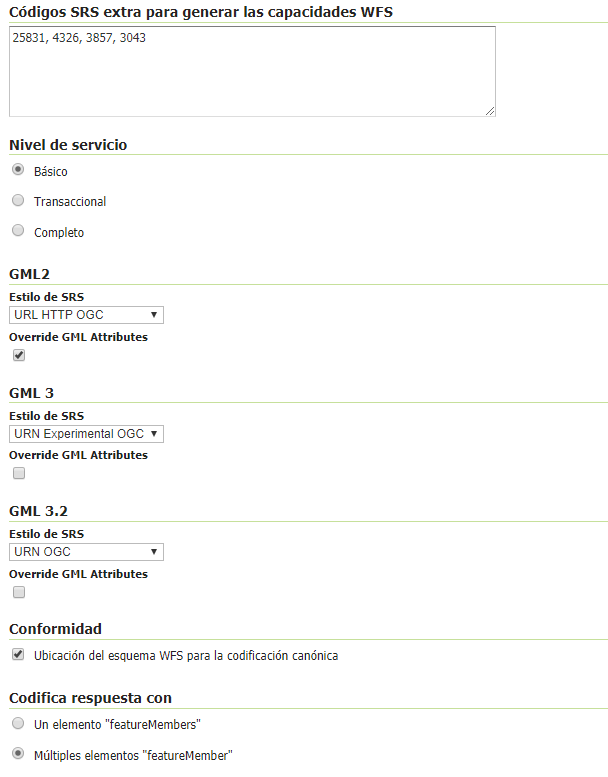

These are the options I have in the WFS service:
