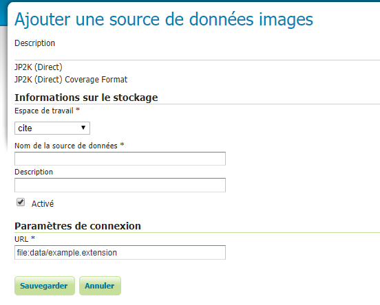

I have the “JP2K (Direct)” option from the datastores, but from this page i cannot choose any file (no button to browse files) :
When i type the URL file:data/… to any JP2 image, then Save, i have this error on the GeoServer interface :
Could not list layers for this store, an error occurred retrieving them: Failed to create reader from file:data/jp2/06-2017-1060-6305-LA93-0M20-E080.jp2 and hints Hints: REPOSITORY = org.geoserver.catalog.CatalogRepository@anonymised.com EXECUTOR_SERVICE = java.util.concurrent.ThreadPoolExecutor@anonymised.com[Running, pool size = 0, active threads = 0, queued tasks = 0, completed tasks = 0] System defaults: LENIENT_DATUM_SHIFT = true GRID_COVERAGE_FACTORY = GridCoverageFactory TILE_ENCODING = null FORCE_AXIS_ORDER_HONORING = http FORCE_LONGITUDE_FIRST_AXIS_ORDER = true STYLE_FACTORY = StyleFactoryImpl FEATURE_FACTORY = org.geotools.feature.LenientFeatureFactoryImpl@anonymised.com COMPARISON_TOLERANCE = 1.0E-8 FILTER_FACTORY = FilterFactoryImpl
And this on the logs :
WARN [coverageio.jp2k] - Unavailable envelope for this coverage
org.geotools.data.DataSourceException: Unavailable envelope for this coverage
at org.geotools.coverageio.jp2k.JP2KReader.setCoverageProperties(JP2KReader.java:176)
at org.geotools.coverageio.jp2k.JP2KReader.(JP2KReader.java:710)
at org.geotools.coverageio.jp2k.JP2KFormat.getReader(JP2KFormat.java:111)
at org.geoserver.catalog.ResourcePool.getGridCoverageReader(ResourcePool.java:1490)
at org.geoserver.catalog.ResourcePool.getGridCoverageReader(ResourcePool.java:1436)
at org.geoserver.catalog.impl.CoverageStoreInfoImpl.getGridCoverageReader(CoverageStoreInfoImpl.java:53)
at sun.reflect.NativeMethodAccessorImpl.invoke0(Native Method)
at sun.reflect.NativeMethodAccessorImpl.invoke(NativeMethodAccessorImpl.java:62)
at sun.reflect.DelegatingMethodAccessorImpl.invoke(DelegatingMethodAccessorImpl.java:43)
at java.lang.reflect.Method.invoke(Method.java:498)
at org.geoserver.catalog.impl.ModificationProxy.invoke(ModificationProxy.java:127)
at com.sun.proxy.$Proxy24.getGridCoverageReader(Unknown Source)
at org.geoserver.web.data.layer.NewLayerPageProvider.getItemsInternal(NewLayerPageProvider.java:86)

On Thu, May 23, 2019 at 8:25 AM Gabriel Vatin <gabriel.vatin@anonymised.com> wrote:

Le 23/05/2019 à 08:16, Andrea Aime a écrit :
“Anyways, what if you try to open a single image with the JPEG2000 reader?”
If you cannot publish a single file, there is no way that you’ll be able to put together a mosaic
