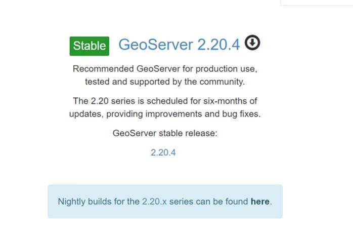

You can get the matching versions of the extensions for a released Geoserver from the same page where you can download Geoserver. In your case for 2.20.4 from http://geoserver.org/release/stable/ and the direct link is https://sourceforge.net/projects/geoserver/files/GeoServer/2.20.4/extensions/geoserver-2.20.4-vectortiles-plugin.zip
The snapshot extensions and community modules match with the nightly builds of Geoserver which are found through this link:
Test with matching versions and report if you still have troubles.

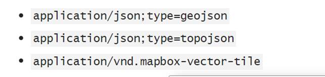

I have downloaded the files from the first link I entered above and put them in the folder WEB-INF/lib but I am still not seeing the tile formats options (shown below) when creating a new layer.
I see that it mentions the version of the extension must match the version of GeoServer. I am using the following version of GeoSever because that was the one available for download.
I see in the name of the extension GeoServer-2.21. Do you think that is why the extension is not working? And if so, do you know where version 2.21 can be downloaded from?
