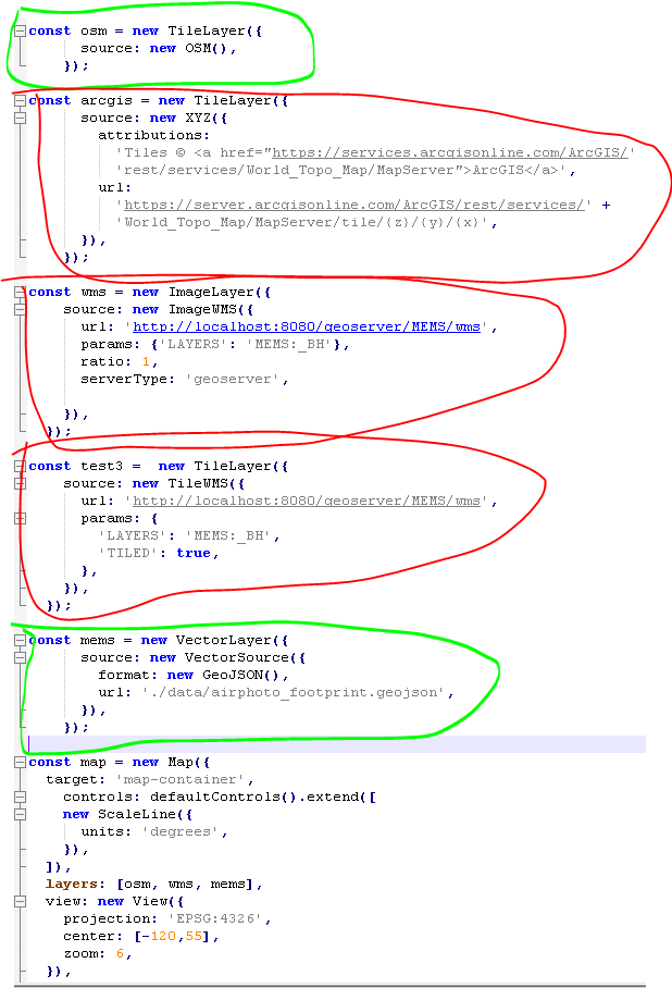

Not sure I am allowed to post here regarding OpenLayer loading WMS from geoserver. Please see below code. If I have only OSM and mems layers, then I can see the map. But if I tried to load one of the three red box layers (arcgis, wms and test3) I can not see any map.
Is there anyone know why it did not bring the WMS from Geoserver. Even I tried ArcGIS world topo image but still no luck. I can see wms layer in Geoserver layer view.

According to the openlayers docs there is not an ImageLayer nor is there a TileLayer it is Image and Tile
So change
const arcgis = new TileLayer({…
to
const arcgis = new Tile({…
and
const wms = new ImageLayer({…
to
const wms = new Image({…
and see how that goes

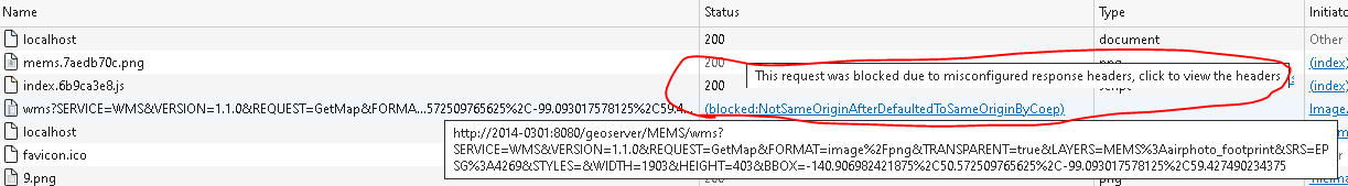

Thanks for your help. It is still not working.
I looked into development tool in browser and noticed below (red circle). I do not know what is that? Is there any setting I need to do?
If I type below URL then I can get PNG image.

The browser is expecting the request to be to http://localhost:8080/… But it looks like you have a url going to http://2014-0301:8080/… Which is causing a CORS issue.
