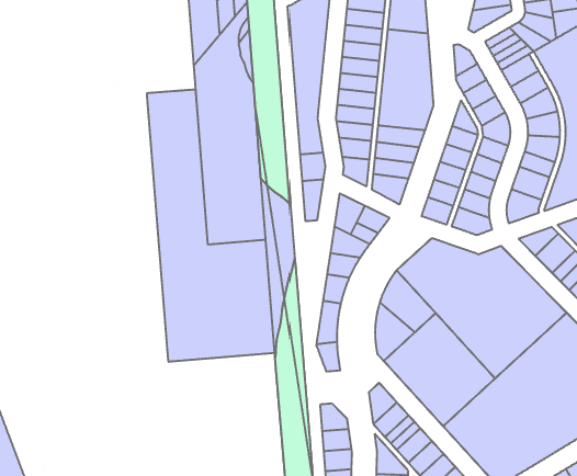

Hi everyone,
After a few more trial and errors, I finally figured out the source of the Topology Exception. My source data contains a mix of MultiPolygon and Polygon geometries. When they are put into a FeatureCollection to be consumed by the WPS, everything was converted to Polygons. This led to an issue with the Multipolygons. In green below is one of the Multipolygons that was converted to Polygon. Notice the line connecting the two parts, it was a side effect from the conversion because the last coordinate always needs to match with the first coordinate for a Polygon so the first coordinate was added in the end of the coordinate sequence by the conversion. This made the geometry invalid.
The visualization really helped me understand the problem. To fix it, I broke the MultiPolygon into multiple Polygons and then put the polygon into the FeatureCollection. No further TopologyException was reported ever since.
Thanks everyone for reading my question and thank you Dominique for your suggestions.
Regards,
Oscar
