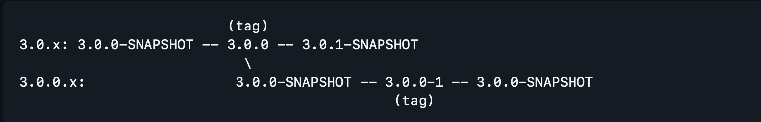

What happened to GeoServer 3.0 GSIP-226:
To avoid “code freeze” andrea asked that we break out a 3.0.0.x branch between release-build and release publish.
Insight: This will actually be good because any changes to release script will occur on main while the 3.0.0.x (and 3.0.0 tag) can remain unchanged.
Action: Make new release scripts for GeoServer 3, rather than try and maintain one script that works with 2.x and 3.x (see release breakage due to removal of docs/en/requirements.txt needed for release script)
So main branch will use build_release3, and then publish_release3
So 2.28.x uses build_release.sh, and then publish_release.sh
Note jenkins_release.sh looks at version numbers, so it can take care of calling the correct script above
