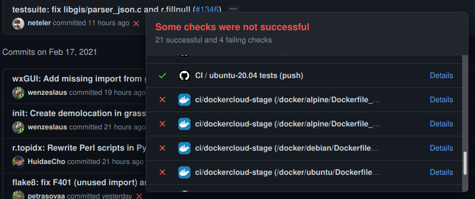

Docker build which runs on each commit in master branch on hub.docker.com fails. I’m not managing these builds, so I see only that something starting with ci/dockercloud-stage (/docker/alpine/Dockerfile_` fails in the. The ones which are substantially different from what we test on GitHub should be tested there for each PR using GH workflow. On the other hand, if there is no way of fixing it and/or no need for them, the best course of action is to remove them. Each commit on master branch now shows as a failure [1].

I guess so. I refer to those which you can see in commits on master branch. See attached.

The first ones failing are already on Feb 12.

I found it: docker/alpine/Dockerfile_alpine_wxgui builds fail.
I have deactivated the builds now in dockerhub and suggest to drop the
file entirely:
https://github.com/OSGeo/grass/pull/1372
