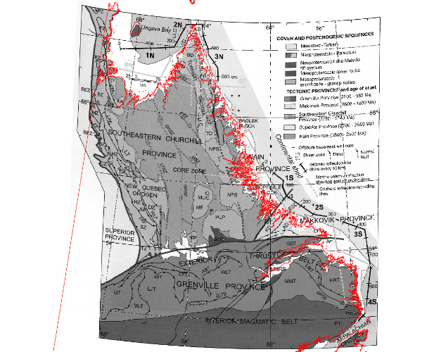

What is the best approach to take when georectifying a scanned, projected map (but the projection is unknown)? Is it necessary to georectify the map first into a lat-long location and then r.proj the map into a target projection? This is the method I used, using 20 GCPs (reading lat-long graticule intersections from the map) and a cubic rectification, but there is still a lot of error (see attached; I overlaid the GSHHG coastline for comparison).
I’m not sure if I am going about this the correct way.

I don't have too much experience with this, but I think it's a good
approach. But you also need to know the ellipsoid, not sure if that
could cause the misalignment.

Thanks, I have assumed WGS84, where the map was made in 2002; I'll also try
NAD27 as that is not uncommon in the region.
Eric
If you have a good coastline map, can you just geo-rectify the new map to it using coastline features as GCPs? Then it’ll have the same projection as the coastline layer and you can re-project it to your working projection.
