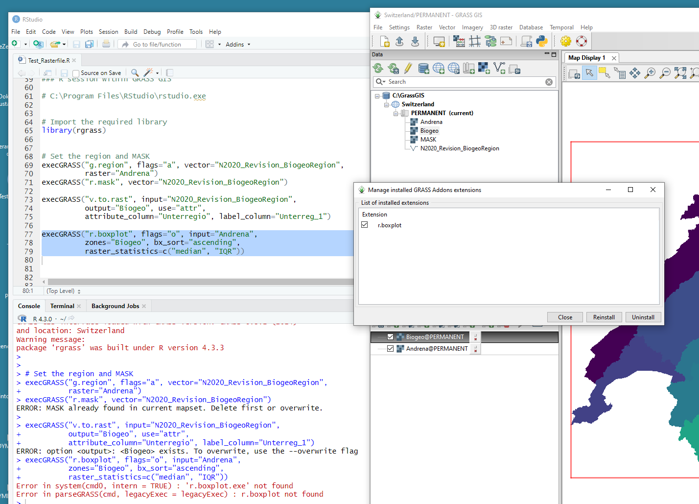

Yes I have installed successfully all addons (visualised in the figure below). Additionally I was able to run the code using GUI or GRASS GIS command.
  • Managed installed GRASS addons extensions: then r.boxplot is visible as installed.
As g.region, r.mask, v.to.rast is working and the error was just related to r.boxplot, I was wondering if I need to install addons a second time in rstudio?

If you ran execGRASS("g.extension", extension="r.boxplot", operation="add"), the add-on will not be found until you restart the R session in RStudio (parseGRASS caches all *.bat found the first time it is used on Windows). GRASS extensions are installed in GRASS, not R, but can be installed through execGRASS(). In that case, on Windows, the R session needs to restarted. In any case, I guess that making the boxplot in R is easier, see for example: https://rsbivand.github.io/rgrass/reference/readRAST.html.
  * Managed installed GRASS addons extensions: then r.boxplot is visible as installed.
