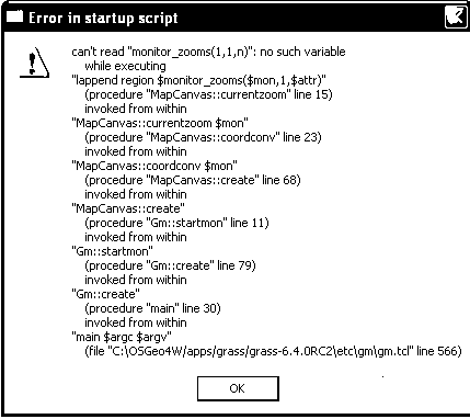

I have downloaded grass 64 windows from http://trac.osgeo.org/osgeo4w/ location and then download and install according to installation procedure.
after download and installation when I start the GRASS form start manu “GRASS 6.4.0RC2” swindow viewed. I am using spearfish data in GIS DataBase located at mydocuments.When I click ENTER GRASS the following error message appears " Error setting region( Problem with g.region? ): child killed; unknown signal " and after thar an error window appears whis is attached here with as a picture.

This will be caused by a GDAL problem (see below).
Again when i start QGIS i got error message that " ippj-5.3.dll "
This is discussed here:
http://trac.osgeo.org/osgeo4w/ticket/27
Try in the installer to uncheck (don't install) libs->libjpeg-ipp.
Markus
