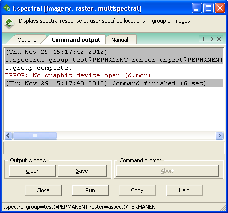

Do you have complete solution for i.spectral in windows. Before, you telling I am trying, installing gnuplot and set the path variable. But still there prob with d.mon.
I need this command very much. If you have any alternative solution then suggest me. As I need spectral responses in user specified region.

i.spectral is not running under windows version grass. I use here Grass 6.4
for windows.
How I can fix the problem. If there is any other alternative for windows
then suggest me
or fix the error for i.spectral.i.spectral works fine for linux but I need it for windows.
gnuplot [1] is needed for i.spectral, but gnuplot isn’t part of
osgeo4w-wingrass/wingrass-standalone
try
- install gnuplot from [1]
- put path/to/gnuplot in %PATH%
best regards
Helmut
