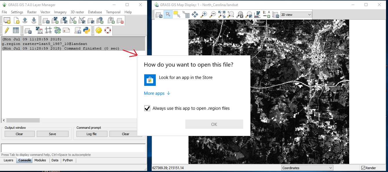

I’m running GRASS 7.4.0 in Windows 10 and when I try to run the command
g.region raster=MyMap
Automatically opens a dialog box from Windows 10 asking “How do you want to open this file?”

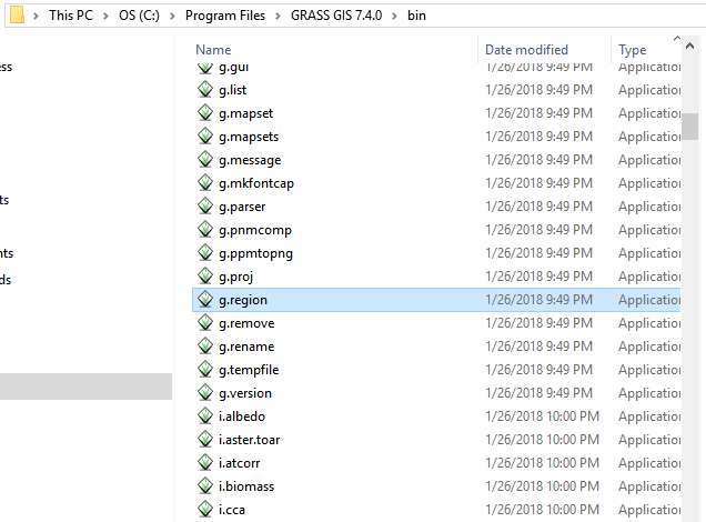

I went through the “more apps” option and navigated to:
“C:\Program Files\GRASS GIS 7.4.0\bin\g.region.exe”
and choose it… but did not work…
How could be possible to solve this issue to be able to run g.region command?
