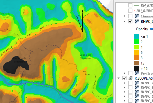

I tested in GRASS, but the results are not as expected. Selected the upstream calculation method and didn’t marked any option (optional tab). The vertical distance from stream to ridge line is not good and the crest of the valley is not correct. I did tested with SAGA the vertical distance from stream to ridge line along the watercourse and validated it manually (see image bellow).
In GRASS, the addon says:
difference
Name of output map of elevation difference to the target (outlet, node, stream, divide, maximum) along watercourse. The map is of DCELL type.
distance
Name of output map of distance to the target (outlet, node, stream, divide, maximum) along watercourse. The map is of DCELL type.
I thought that should it be possible to select the distance and difference from the stream to the divide (ridge line).
Well, it would be great if GRASS can do it.
