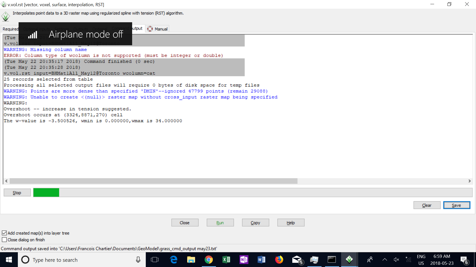

Simulation ran all night with the 70 k points and still at 10%. I reran to get the error message but still not there yet.
(attachments)
grass_cmd_output may23.txt (980 Bytes)

thanks a lot. it seems I am might be on the right path with other comments. I could having an issue with a too high resolution.
(attachments)
