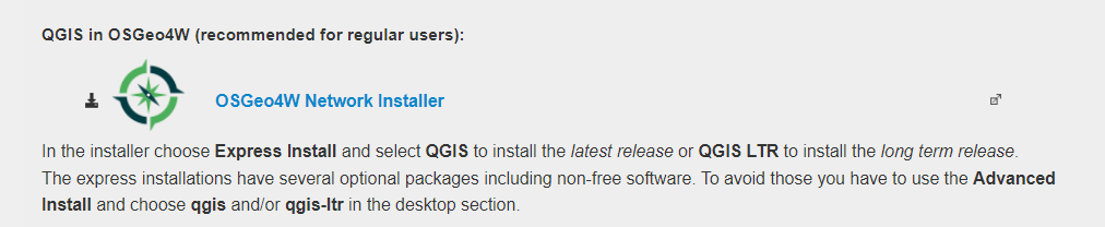

I use all default options and when I tried to use GRASS GIS,I got the following error.
GRASS_INFO_ERROR(17904,1): Unable to load GDAL library
GRASS_INFO_END(17904,1)
Would you please let me know if you have any idea to solve this problem?
Could you please try to install the “gdal-303-runtime” package (when you choose advanced install, it is in the libs section). If I am not mistaken, this is a glitch that should be fixed with the upcoming GRASS GIS 8.0.2 release.
