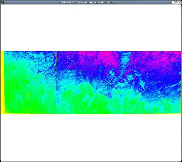

One big problem occurs after the import when patching the imported hdfs which
does not work properly (see attached image) - but using ERDAS 9.1 patching
works fine.
Any idea how this error might be fixed?
Martin

it was a (re-)projection problem - the problem also occurs in ERDAS but wasn't
visible at the first sight.
Solved it by patching it using MRT and doing the processing afterwards.
