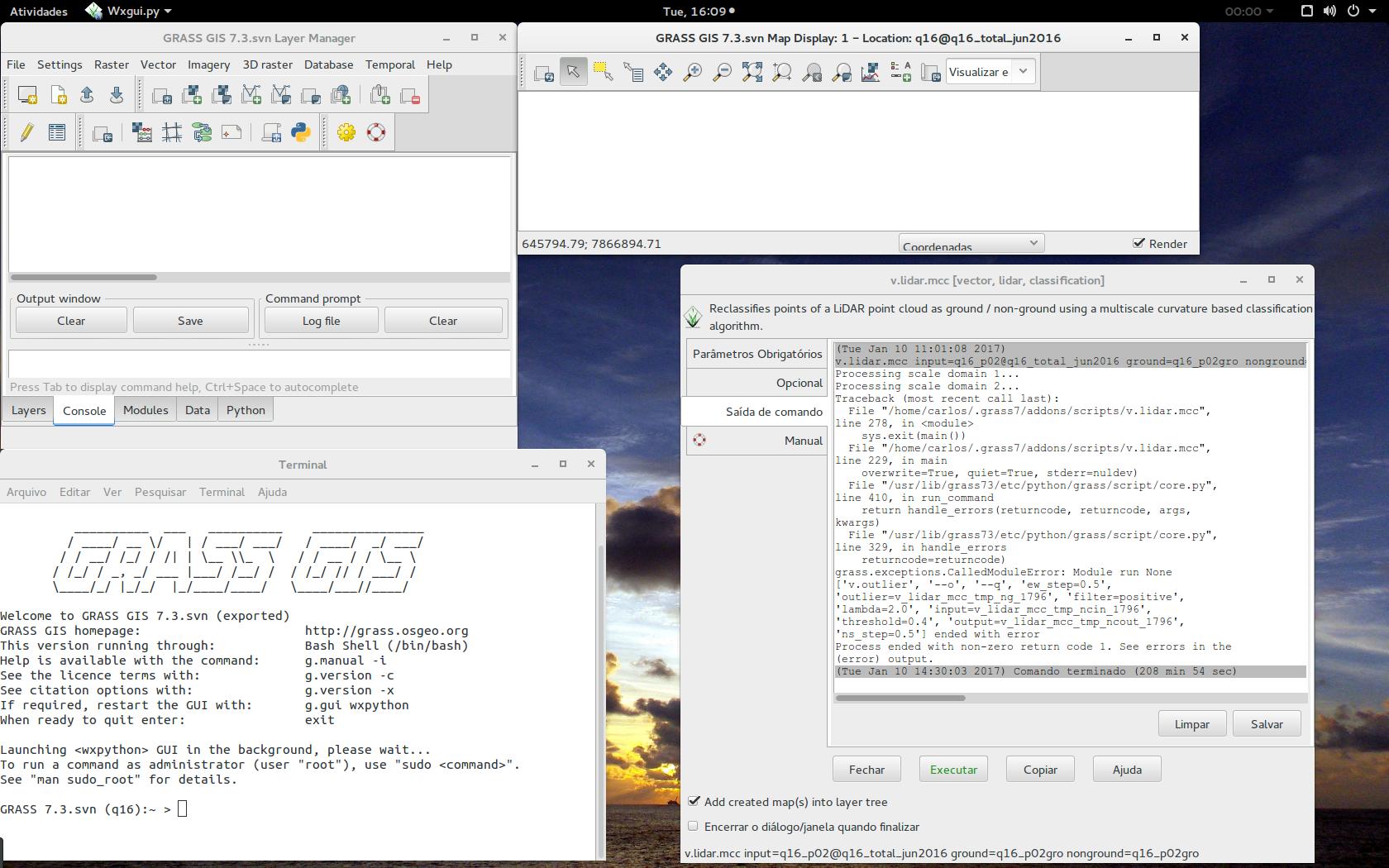

There should be some error in terminal too, could you include it?
On Mon, Jan 9, 2017 at 2:43 PM, Rafaela Soares <rafaelaniemann@gmail.com> wrote:
Hi Moritz!
I've reinstalled v.lidar.mcc using g.extension in another computer, but it
seems that it did not work.
He returned this report:
(Mon Jan 9 13:39:58 2017)
v.lidar.mcc input=q16_p02@q16_total_jun2016 ground=q16_p02gro
nonground=q16_p02nongro
Processing scale domain 1...
Processing scale domain 2...
Traceback (most recent call last):
File "/home/carlos/.grass7/addons/scripts/v.lidar.mcc",
line 278, in <module>
sys.exit(main())
line 229, in main
overwrite=True, quiet=True, stderr=nuldev)
File "/usr/lib/grass73/etc/python/grass/script/core.py",
line 410, in run_command
return handle_errors(returncode, returncode, args,
kwargs)
line 329, in handle_errors
returncode=returncode)
grass.exceptions.CalledModuleError: Module run None

Apparently the module hasn’t created this temporary files. I collected a “Print Screen” and really dont know resolve this problem. Today, I reprocesseded another point clouds, but the same problem appeared.
(attachments)

Hi All!
Apparently the module hasn't created this temporary files. I collected a
"Print Screen" and really dont know resolve this problem. Today, I
It's weird you didn't get any other error... Could you reproduce it
on smaller point cloud and share it with us (off list)?
Anna
*Rafaela Soares Niemann*
Geografa - Universidade Estadual de Campinas - UNICAMP
Mestranda em Geografia - Universidade Estadual Paulista - UNESP Rio Claro

Hi Rafaela,
this is too big for testing, please make it smaller. You will at least
see if the problem is related to the size of the dataset. Also, as
Moritz suggested you, please run the command:
v.outlier --o ew_step=0.5 outlier=outlier filter=positive lambda=2.0
input=mylasinput threshold=0.4 output=output ns_step=0.5
because this is the command that actually failed and it should report
some errors.
Thank you,
Anna

>> >>> File "/home/eddard/Downloads/v.lidar.mcc.py
>> ><http://v.lidar.mcc.py>",
>> >>> line 243, in
>> >>> <module>
>> >>> sys.exit(main())
>> >>> line 214, in
>> >>> main
>> >>> grass.run_command('g.remove', vect = temp_ncin, quiet =
>> >>> True, stderr = nuldev)
>> >>> kwargs)
>> >>> ['g.remove', '--q', 'vect=v_lidar_mcc_tmp_ncin_18102'] ended
>> >>> with error
>> >>> Process ended with non-zero return code 1. See errors in the
>> >>> (error) output.
>> >>> Error in atexit._run_exitfuncs:
>> >>> File "/usr/lib/python2.7/atexit.py", line 24, in
>> >>> _run_exitfuncs
>> >>> func(*targs, **kargs)
>> >>> line 106, in
>> >>> cleanup
>> >>> grass.run_command('g.remove', vect = '%s,%s,%s' %
>> >>> (temp_ng, temp_ncin, temp_ncout), quiet = True, stderr =
>> >>> nuldev)
>> >>> kwargs)
>> >>> CalledModuleError: Module run None ['g.remove', '--q', 'vect
>> >>> =v_lidar_mcc_tmp_ng_18102,v_lidar_mcc_tmp_ncin_18102,v_lidar
>> >>> _mcc_tmp_ncout_18102'] ended with error
>> >>> (error) output.
>> >>> Error in sys.exitfunc:
>> >>> _run_exitfuncs
>> >>> line 106, in
>> >>> cleanup
>> >>> nuldev)
>> >>> kwargs)
>> >>> ['g.remove', '--q', 'vect=v_lidar_mcc_tmp_ng_18102,v_lidar_m
>> >>> cc_tmp_ncin_18102,v_lidar_mcc_tmp_ncout_18102'] ended with
>> >>> error
>> >>> (error) output.
>> >>> (Mon Dec 5 22:28:30 2016) Comando terminado (4983 min 19 sec)
>> >>> What can I do wrong?
>> >> I don't think you are doing anything wrong. It rather looks like the
>> >> version you use is and old version of v.lidar.mcc. The parameters of
>> >> g.remove have changed in grass 7 and v.lidar.mcc does not use a call
>> >such
>> >> as "grass.run_command('g.remove', vect = '%s,%s,%s'" anymore.
>> >> Try reinstalling v.lidar.mcc using g.extension.
>> >> Moritz
On 11/01/17 05:21, Anna Petrášová wrote:
Hi Rafaela,
some errors.
I see this in v.lidar.mcc:
grass.run_command('v.outlier',
  input=nc_points, output=temp_ncout, outlier=temp_ng,
         ew_step=xs_s, ns_step=ys_s, lambda_=f, threshold=t,
         filter='positive',
I guess the stderr=nuldev is the reason why no error message appears.
Maybe this call should be in a try-except check ?
Moritz
