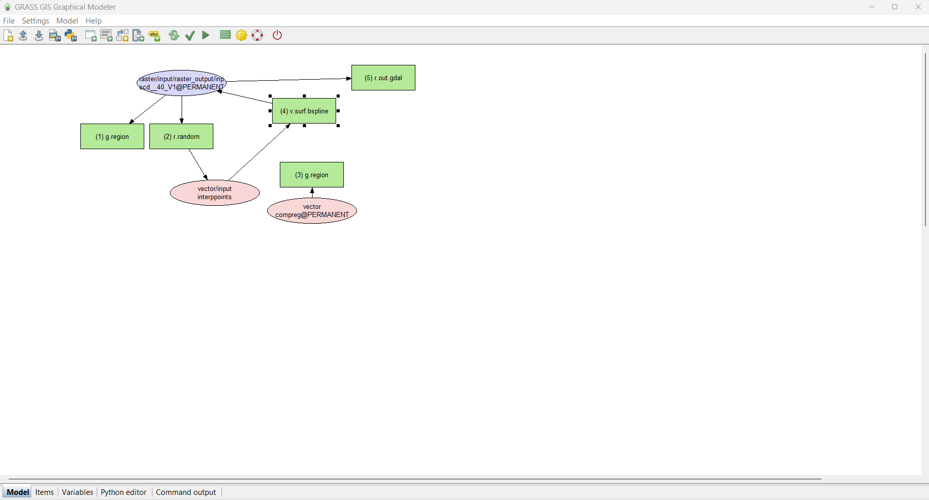

I’m trying the start getting familiar with the graphical modeler as I have a lot of raster operations that I need to automate.
I have 456 raster layers that I (1) want to interpolate using v.surf.bspline, and then (2) export to six different folders, 76 rasters for each.
I have designed the workflow in the graphical modeler using just one layer to see that everything works the way that it should, and it does!
However, I can’t for the life of me figure out how to set up a loop so that it can iterate through all the remaining layers. I’m trying my best to
read the manual, but since all of this is new to me, I can’t figure out (1) how to add several raster layers. Whenever I use the “add data to model” I can
only add one layer from the drop down list. I also don’t know if I need two loops, one for interpolation and then one for the raster export.
I have attached a screenshot that outlines my model. I hope you’ll be able to guide me in the right direction!

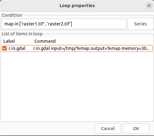

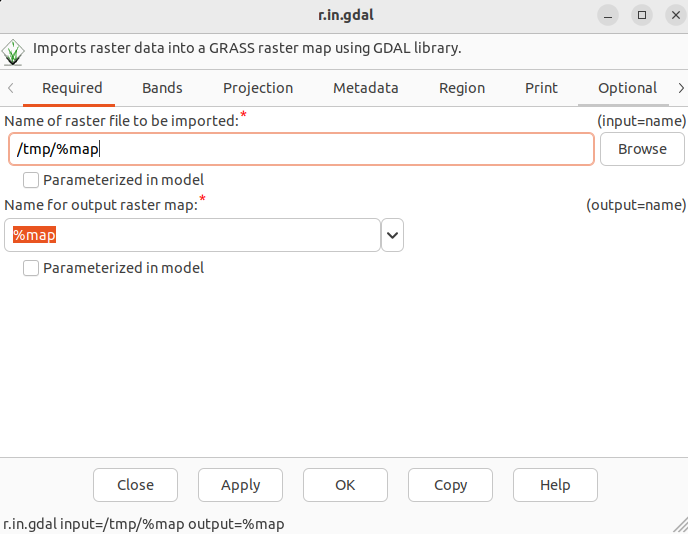

You define your models using a variable, for example %map as I did for my r.in.gdal:
Then you can define a loop using the “Add loop/series to model” button (or Model → Add loop / series). If the maps were already imported, you could automatically loop through them based on a pattern. As there are outside, you would need to write all of them manually (or copy from some list of yours) which is pretty annoying but possible (see the field “Condition” in the example below):
