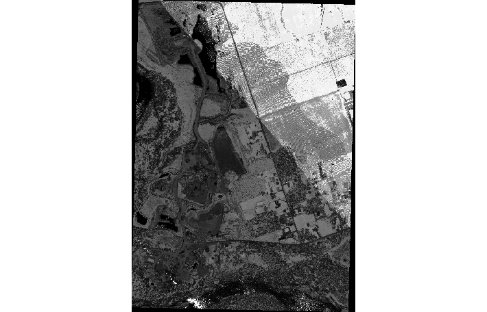

   This LDQ is produced by the intensity of returns of the highest hits in
the area of coverage. It looks like a low resolution black-and-white aerial
photograph while generated from 1.5' (45cm) horizontal resolution LiDAR
scans (see attached screenshot.png). Really helpful in correlating specific
project areas to the elevation map and other features.

Rich, I downloaded a sample LDQ file: 'LDQ-43120C4.zip'.
Some '.tif' files are inside the subdirectory 'Intensity'. GDAL says for
one of them:

Indeed, using this file's geo-metadata to create a new GRASS location,
ends up in `r.in.gdal` complaining while performing the projection
check.
Perhaps the geo-metadata in these .tif files are not a good match for
GRASS GIS (and its mechanism to detect reference systems).
The 'Shapefiles' directory contains various ancillary vector maps. One
such map is 'OLC_1-100th_Quadrangle_Index.shp' whose corresponding .prj
file content is:
PROJCS["NAD_1983_HARN_StatePlane_Oregon_North_FIPS_3601_Feet_Intl",GEOGCS["GCS_North_American_1983_HARN",DATUM["D_North_American_1983_HARN",SPHEROID["GRS_1980",6378137.0,298.257222101]],PRIMEM["Greenwich",0.0],UNIT["Degree",0.0174532925199433]],PROJECTION["Lambert_Conformal_Conic"],PARAMETER["False_Easting",8202099.737532808],PARAMETER["False_Northing",0.0],PARAMETER["Central_Meridian",-120.5],PARAMETER["Standard_Parallel_1",44.33333333333334],PARAMETER["Standard_Parallel_2",46.0],PARAMETER["Latitude_Of_Origin",43.66666666666666],UNIT["Foot",0.3048]]
The file 'OLC_EASTERN_OR_TIR_2012_0_75_UTM.prj', however, appears to be
a match for the .tif file (?).
PROJCS["NAD_1983_CORS96_UTM_Zone_10N",GEOGCS["GCS_NAD_1983_CORS96",DATUM["D_NAD_1983_CORS96",SPHEROID["GRS_1980",6378137.0,298.257222101]],PRIMEM["Greenwich",0.0],UNIT["Degree",0.0174532925199433]],PROJECTION["Transverse_Mercator"],PARAMETER["False_Easting",500000.0],PARAMETER["False_Northing",0.0],PARAMETER["Central_Meridian",-123.0],PARAMETER["Scale_Factor",0.9996],PARAMETER["Latitude_Of_Origin",0.0],UNIT["Meter",1.0]]
I used this vector map as a source, created a new Location/Mapset,
imported one '.tif' file without problems. The "FIPS 3601" is not the
correct one to use for the '.tif' files, in this example LDQ I
downloaded.
Hope the above is useful for you too.

On Sat, 14 Jul 2018, Nikos Alexandris wrote:
gdalinfo int_43120C4404.tif -proj4 -nomd
Nilos/Helmut:
   For some reason I looked at the .xml file rather than running gdalinfo on
the 100th/quad .tif file. Creating a new location with that proj.4 string
allowed me to import the DLQ, but ... I still needed to use the '-o'
projection override. IIRC, the proj.4 string units are feet, but the image
itself is apparently in meters. Well, it's ESRI software and as long as it
imports I'm happy.
   The new imported raster map reprojected to the project location, so the
remaining question (which may not have an answer) is why three separate
color bands are imported (RGB)? The display is monochrome and all three
separate images *.red, *.green, and *.blue look the same on the monitor. Can
I display this DLQ in color? (I think the last time I used aerial
photographs or satellite imagery was with grass-4.1 or -5.x.)
Rich
On Mon, Jul 16, 2018 at 5:04 PM, Rich Shepard <rshepard@appl-ecosys.com> wrote:
Nilos/Helmut:
allowed me to import the DLQ, but … I still needed to use the ‘-o’
If you use the -o flag, you are potentially corrupting the data. The safest is to create a new location directly from the data to be imported, unless there is a good reason to assume that the srs info in the data as reported by gdalinfo is wrong.
itself is apparently in meters. Well, it’s ESRI software and as long as it
imports I’m happy.
It does not import, unless the -o flag is used. That means the srs of the location and of the data to be imported do not match.
Try d.rgb
Markus M
Rich
Markus,

Can I display this DLQ in color? (I think the last time I used aerial
Try d.rgb
   Okay. Thanks.
Rich

* Rich Shepard <rshepard@appl-ecosys.com> [2018-07-16 08:04:59 -0700]:
Nilos/Helmut:
imports I'm happy.
Rich
I also think there might be something special to these images.
From another example file, LDQ-42124C2:
gdalinfo intensity_42124C2_1.tif -norat -nomd
Band 1 Block=64x64 Type=Byte, ColorInterp=Gray
  Description = Band_1
  Min=5.000 Max=255.000
  Minimum=5.000, Maximum=255.000, Mean=150.269, StdDev=39.671
  NoData Value=0
  Overviews: 583x908, 292x454, 146x227, 73x114, 37x57
Band 2 Block=64x64 Type=Byte, ColorInterp=Undefined
  Description = Band_2
  NoData Value=0
Band 3 Block=64x64 Type=Byte, ColorInterp=Undefined
  Description = Band_3
  NoData Value=0
Is it "ok" to have identical stats for all layers?
Nikos
