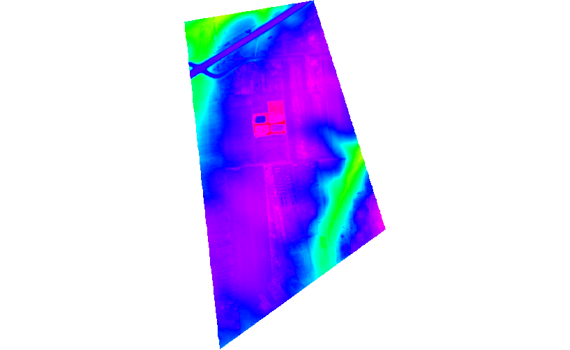

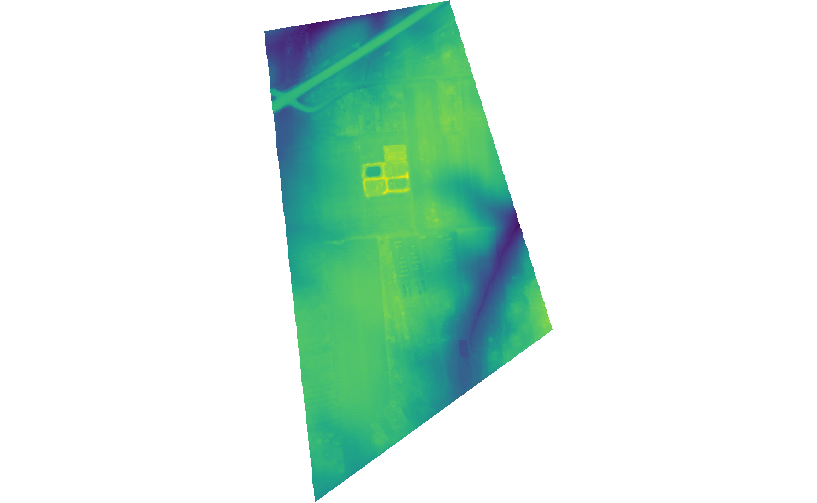

   Also, there are differences in the elevation maps produced by different
grass versions when the same source DEM is re-projected. The same command
was used in each version:
r.proj --o loc=Oregon-Dayton-feet map=topography in=be_cropped out=be_cropped
meth=bilinear
   The output from 7.0.x is smaller, and shows greater elevation differencs,
that those of 7.2.svn and 7.3.svn (the latter two appear the same); copies
attached.
   If anyone has suggestions on identifying what's different on this host
that prevents Itzi from running, please share your expertise with me.
Rich

If a GRASS command gives really different results by different GRASS
versions and the different behaviour isn't documented in the manual or in
the news of the new release, the best way that this will be checked:
- open a ticket at trac (1)
- provide data and used commands to reproduce the issue
otherwise there is a good chance that
- the issue will get lost in the mailing list while the subject of the
threats points to another issue
- devs can't test the issue
(1) https://trac.osgeo.org/grass
best regards
Helmut

In order to find out:
Calculate a "differences" map to see if the *values* are different by
using r.mapcalc along with the "differences" color table provided by
r.colors.
Is is mentioned
https://trac.osgeo.org/grass/wiki/Release/7.2.0-News#GUIchanges
- cartography in Map Display:
   - new color tables which are perceptually uniform: viridis and grass
   - viridis color table is the new default replacing rainbow (manage
with G7:r.colors)
  Done.
For the email ist archive:
On Tue, Oct 18, 2016 at 1:32 AM, GRASS GIS <trac@osgeo.org> wrote:
#3185: Maps display differently 7.0.x vs 7.2.svn and 7.3.svn
* status: new => closed
* resolution: => invalid
Comment:
The default color table changed (see #3043), use r.colors to set different
color table.
Ticket URL: <https://trac.osgeo.org/grass/ticket/3185#comment:1&gt;
cheers,
Markus
