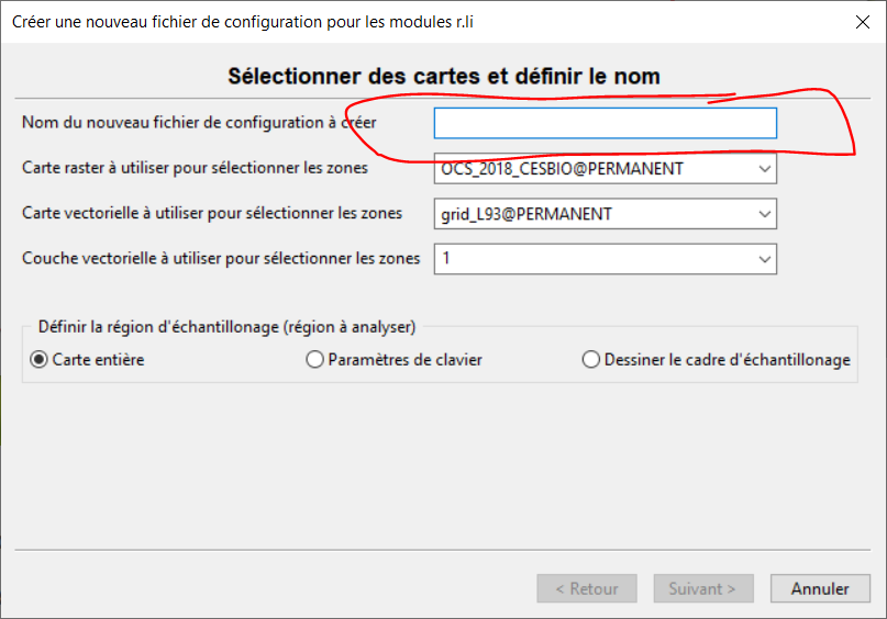

Hello everyone,
I met a problem with g.gui.rlisetup tool on Windows.
It is impossible to type the name of the configuration file in the dialog (the text zone stays blank), thus impossible to click on "Next" button, and to create the file.
Meanwhile I tried on Linux, and it works. So I have to create liconf file on Linux and then, import it on C:\Users\xxx\AppData\Roaming\GRASS7\r.li ...
What's wrong with g.gui.rlisetup tool on Windows ? Is it a bug already described ?
And, where can I find a documentation about the syntax, if I want to create & edit the config file for r.li in a classic editor such as notepad ?

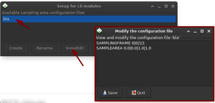

Hello Cyril,
I do not have Windows, but I made some tests in Linux and, as you said, it works fine. So, to understand the syntax of the conf file, I clicked random options and saved a file named bla and then I clicked over Edit/View (see attachment). It’s kinda reverse engineering, but well…
I agree that the output file should be displayed here https://grass.osgeo.org/grass80/manuals/wxGUI.rlisetup.html. Would you mind following that example and providing the resulting config file?
