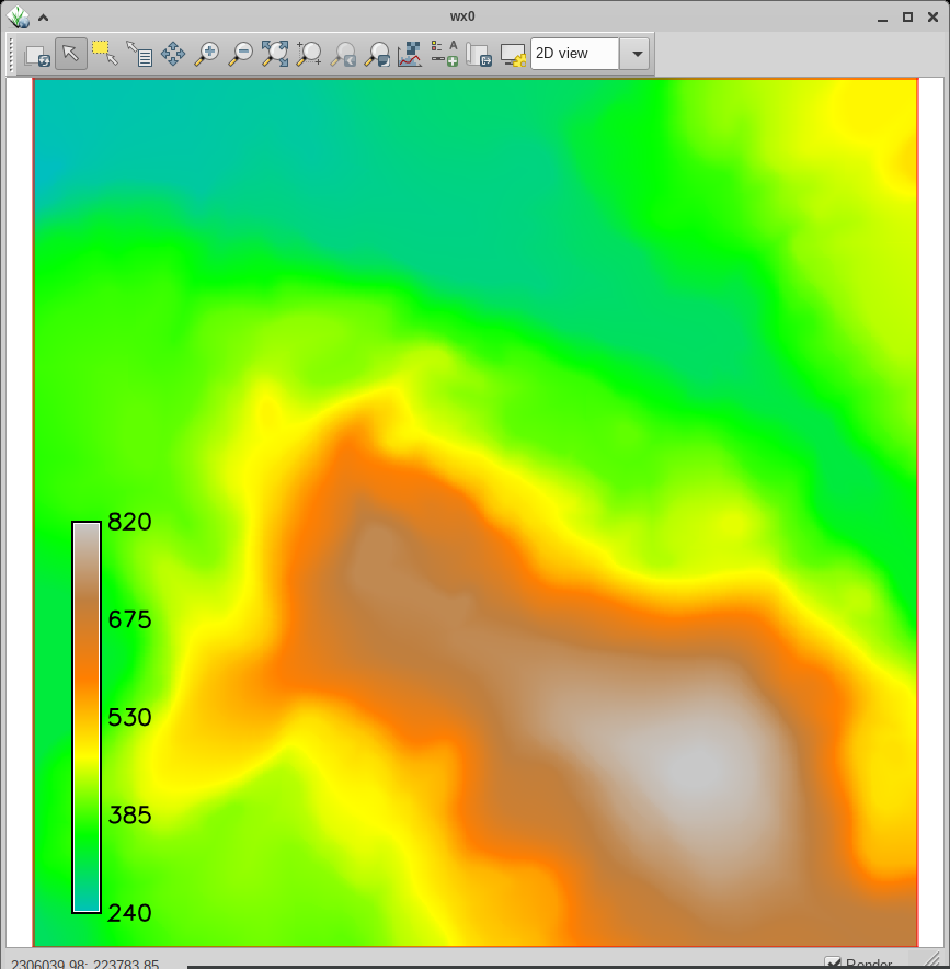

Is there a way to add the elevation color bar for a DEM map to a ps.map?
Since I can add a raster elevation legend using the GUI map window (see
attached), why can't I add in in a .psmap file?
Rich
