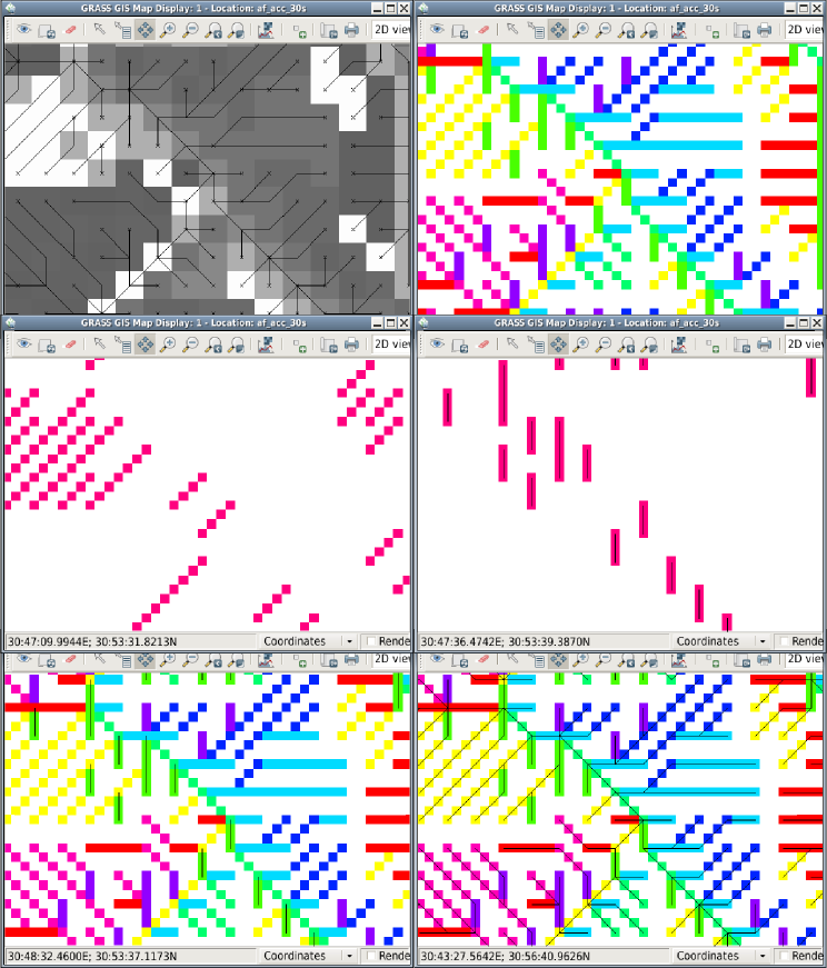

Hi Achim,
i usually produce the river network starting from the flow accumulation, not from the flow direction. If you have a raster elevation map you can get it using r.watershed.
Then, i make as follows:
r.mapcalc 'log_accumulation=log(abs(accumulation)+1)'
r.mapcalc 'inf_river=if(log_accumulation>6)'
6 is a treshold value for the log_accumulation, it is a good value for me but you maybe can try other values. It produces a binary map.
Then:
Raster -> Transform features -> Thin linear features to reduce at 1pixel the lines of the binary raster inf_river and create the new file in_river.
Finally, with r.to.vect you can transform the raster in_river in a vector map.
Hope this helps
Margherita

Content-Type: text/plain; charset="iso-8859-15"Hello,
I am searching for a good idea to convert a raster-flow-direction map
into a vector-network map.Probably I will have to write a script. If it is possible at all...
In case of writing a script it mean to me: how to produce a line within
r.mapcalc?Has anyone a hint?
Cheers,
achimPS:for illustration I attached a little picture
