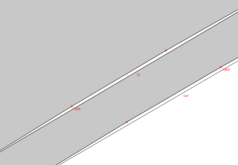

after patching two vector maps I am getting small gaps between areas
(see the attached screenshot).

sorry for the noise - 'rmarea' is the solution, Martin

You might also try tool=snap with a very small threshold. Which tool
or combination of tools works best to remove gaps depends on the data,
some experimenting can be helpful.
