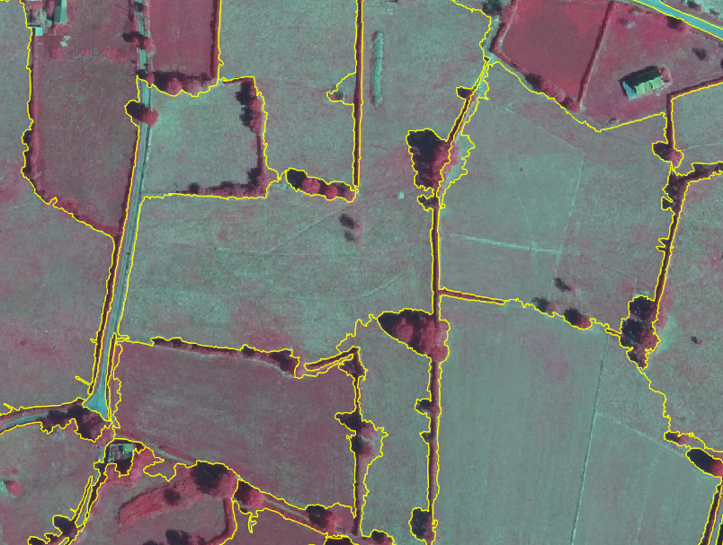

the first SS showing interesting result on crop areas :

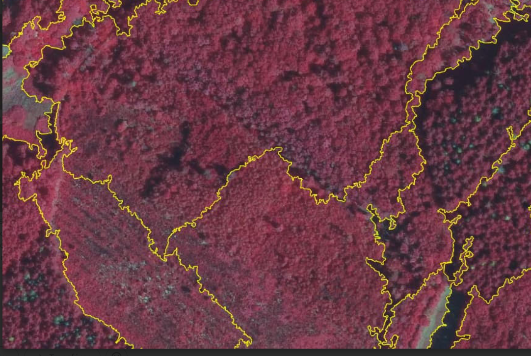

A second SS showing the non relevant result on forest areas :
[cid:image002.png@01DB8D19.9DA95260]
Perhaps for these forest areas, the color/spectral criterion is not relevant. It would be better to generate / integrate texture information? As far as i understood, this GRM OTB module is based only on spectral/colour criterion but not take into consideration texture information.

The result is rather interesting for certain areas, in particular crops areas, without too much vegetation. on the other hand, the method does not seems optimal, in particular for forest areas.
