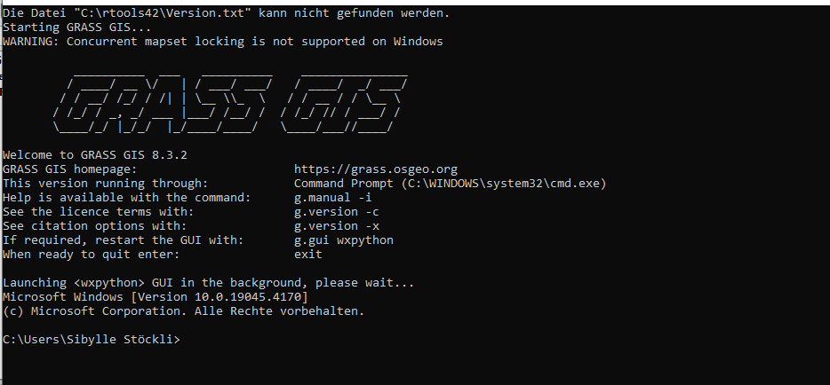

Dear community
Dear Roger
I suppose it is my name
Here the output from the console:
C:\Users\Sibylle Stöckli>
ERROR: Unable to read WIND file: not enough values to unpack (expected 2,
got 1)
library(rgrass)
Der Befehl "library" ist entweder falsch geschrieben oder
konnte nicht gefunden werden.
Kind regards
Sibylle

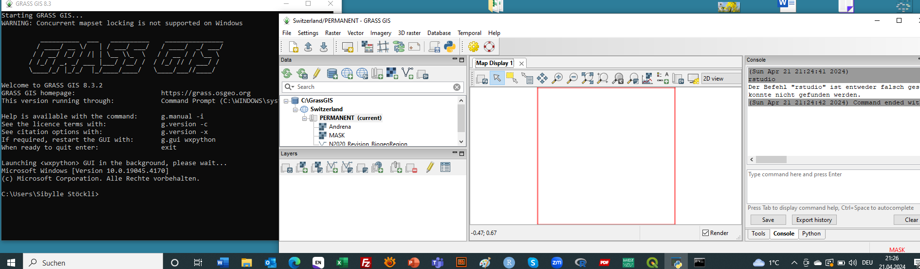

May aim is to use RStudio in a GRASS GIS session, to visualize raster and vector data: e.g. a boxplot of a species raster file or boxplot of a species raster file differentiated for different regions (vector file).
Similar in
https://ecodiv.earth/post/drawing-boxplots-of-raster-values/

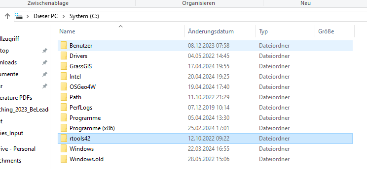

Because of my name with “ö” I changed the location to C:/GrassGIS: this seems to be the solution for the error when staring GRASS. No warming anymore.

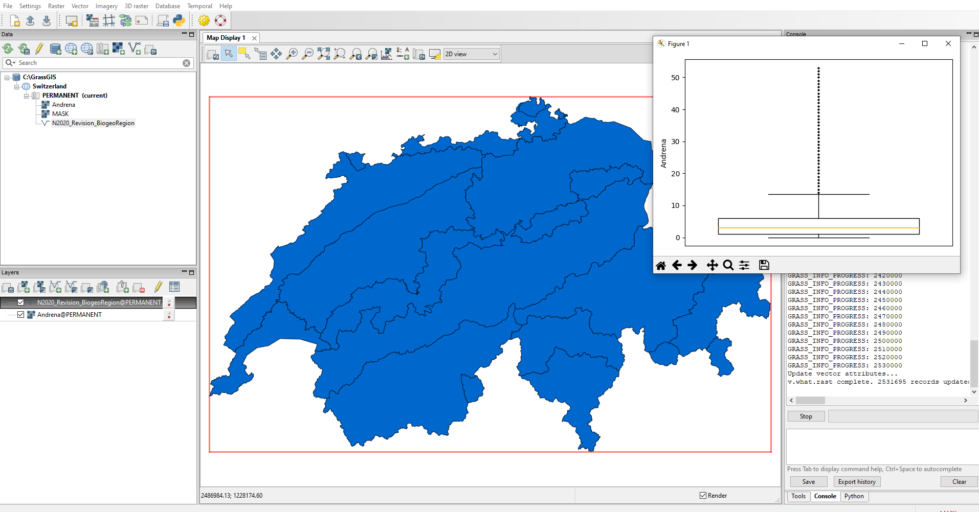

Using the command line, I was able to produce a boxplot.

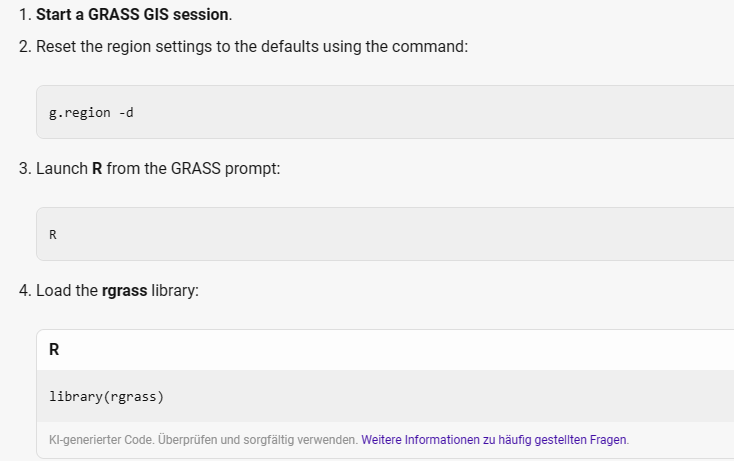

I am more comfortable in R, so I tried starting R inside the GRASS console (as suggested for windows) following the code here:
https://rsbivand.github.io/rgrass/articles/use.html
However, I am still struggling around with the error
The command "library" is either misspelled or
could not be found.
library(rgrass)
Der Befehl “library” ist entweder falsch geschrieben oder
(Sat Apr 20 12:57:24 2024) Command ended with non-zero return code 1 (0 sec)
got 1)
library(rgrass)

Enter:
library(rgrass)
at the R prompt in rstudio, not at the GRASS console prompt; it is an R command.
The error message:
Der Befehl “library” ist entweder falsch geschrieben oder konnte nicht gefunden werden.
comes from Windows, not GRASS or R.

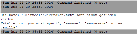

Thanks Roger,
Thanks a lot.
I tried to use R within a GRASS session following the instructions. Hmm the problem seems to be the rtools42 (rtools not being detected), however the path is correct.
Kind regards
could not be found.
library(rgrass)
Kind regards
Sibylle

Rtools is only needed for installation of source packages on Windows. It is spuriously sometimes required by rstudio. Since installing source packages is irrelevant here, maybe drop rstudio?

Thanks Roger,
Thanks a lot.
Kind regards
Sibylle

Thank Roger
Yes. But still the same error even if GRASS GIS is working and RStudio installed.
The command "rstudio" is either misspelled or
could not be found.

Do read the guide please. You must give the full, absolute path to rstudio. This error message is from Windows, as rstudio.exe is not on your path within GRASS. Do also ask for local support, noboby here can see over your shoulder.
Similar in
could not be found.
library(rgrass)
Kind regards
Sibylle

Thank Roger
could not be found.
Roger Bivand
Emeritus Professor
Department of Economics
Norwegian School of Economics, Bergen, Norway
Fra: sibylle.stoeckli@gmx.ch <sibylle.stoeckli@gmx.ch>
Sendt: søndag, april 21, 2024 8:40:05 p.m.
Til: Roger Bivand <Roger.Bivand@nhh.no>
Kopi: grass-user@lists.osgeo.org <grass-user@lists.osgeo.org>
Emne: RE: [GRASS-user] Using RStudio in a GRASS GIS session
Thanks Roger,
Thanks a lot.
Kind regards
Sibylle

Enter:
library(rgrass)
The error message:
