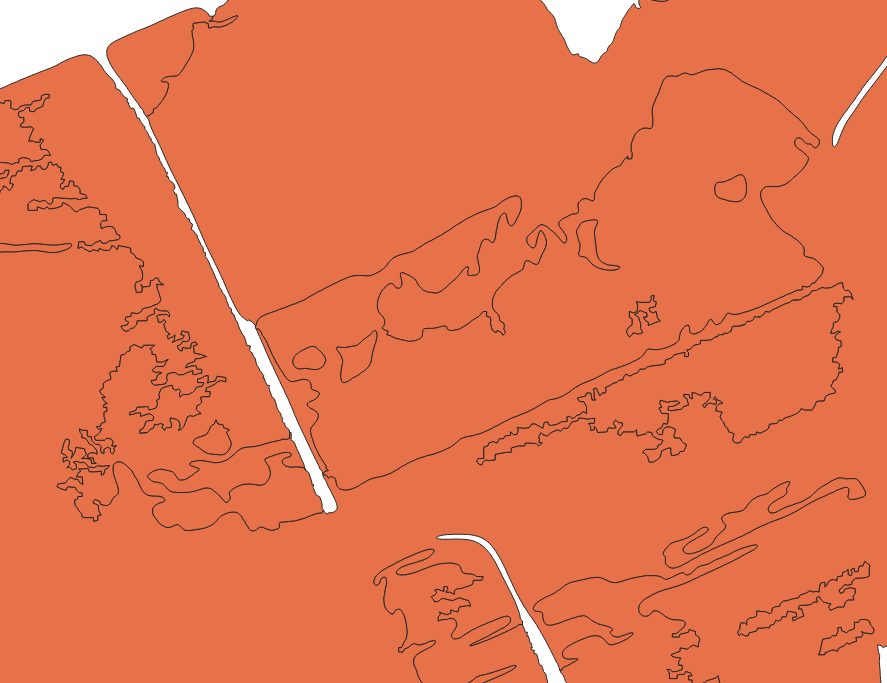

In the process of transforming a raster classification into a vector layer, I use among others the command V.GENERALIZE.
v.generalize input=v_classif_ext@PERMANENT layer=1 type=area type=boundary method=reduction threshold=4 alpha=0.5 iterations=4 output=v_classif_ext_redv.generalize input=v_classif_ext_red@PERMANENT layer=1 type=area type=boundary method=sliding_averaging threshold=100 alpha=0.5 iterations=4 output=v_smooth_1
with
grassversion=79
srid=2154
And I wonder why the smoothing result is not homogeneous, even sometimes for the same polygon.
Any idea about the reason?

Yes i try with other methods of v.generalize tool with same problems.
I realize that if the generalisation tool creates a topological error on a part of the vector then the tool does not treat this part and leaves it as it is.
I didn’t succeed in forcing him to do it.
As a workaround i used https://mapshaper.org/ that implement the Visvalingam algo that work fine with a real time result!
(see https://gis.stackexchange.com/questions/87505/grass-v-generalize-method-douglas-not-working-as-expected)
My challenge is now to create a tool in grass with this Visvalingam algo.
