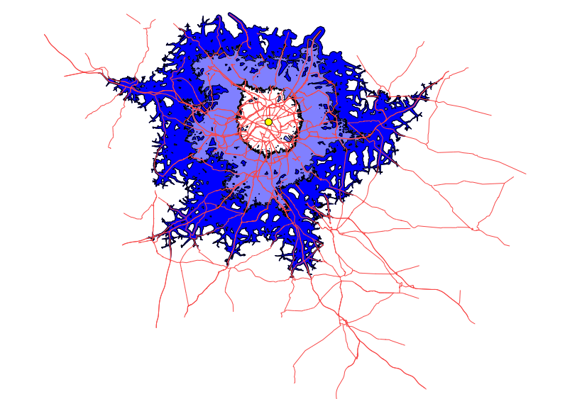

When i modify the resolution nres/ewres from 1 to "150", i have no longer
error message. But when i try a process with a resolution with a value <
150, the process is endless...
According to you, the results generated at this resolution (150) would be
relevant? valid?
I loaded the output vector into qgis. The results are seem incoherent. The
curves show that we can go in 15 minutes on the other side of Paris! In
reality, From my starting point we would go much further toward toward north
than south west...
I use OSM data. I edited and populated the max speed field thanks to the
value of another filed (type of road).
How to explain this incoherence? Due to v.isochrones? Due to resolution? Due
to input maxspeed values ?
I am annoyed because it seems impossible to generate the results for a
better resolution than 150.
Thanks.
relevant? valid?
than south west...
Difficult to say without the data. At this stage, v.isochrones should probably be considered beta, notably because of a significant rewrite, so it might be v.isochrone's fault. Then again, as I mentioned in my response to your other mail, I'm not sure that you are calling v.isochrones with the correct input data.
Could you make your data available off-list, so that I can experiment with it myself ?
with it myself ?

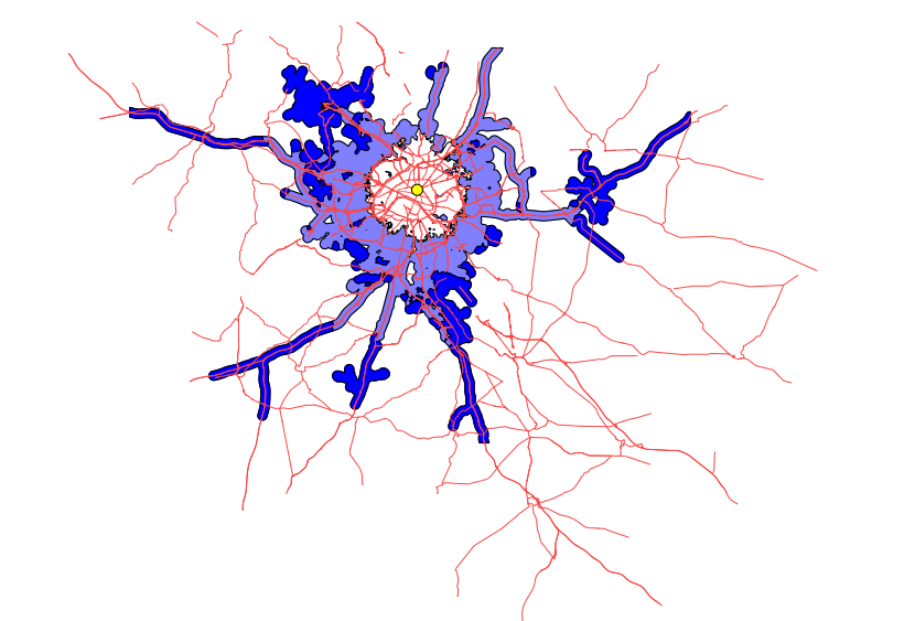

I've done a quick trial with OSM data for Ile-de-France treated as follows:
- reprojected to EPSG 2154 using ogr2ogr
- imported into GRASS
# just to make it quick I just set all roads that do not have a maxspeed to maxspeed = 50:
- v.extract roads2154 where="type like 'primary%' OR type like 'secondary%' OR type like 'tertiary%' OR type like 'motorway%' OR type like 'residential%'" output=roads
- v.db.update roads col=maxspeed value="50" where="maxspeed is NULL"
- v.db.addcolumn roads col="length double precision"
- v.to.db roads op=length col=length
- v.db.addcolumn roads col="cost double precision"
- v.db.update roads col=cost qcol="(length/(maxspeed*1000))*60"
- v.net -c roads op=nodes out=roads_with_nodes
- g.region vect=roads_with_nodes res=10 -ap
- echo "652625|6864473" | v.in.ascii in=- out=start
- v.isochrones roads_with_nodes start=start time_steps=15,30,45 isochrones=isochrones method=r.cost cost_column=maxspeed
(time = 3m20)
and
- v.isochrones roads_with_nodes start=start time_steps=15,30,45 isochrones=isochrones method=v.net.iso cost_column=cost max_distance=1000
(time = 1m9)
See attached images for the result (only motorways and primary roads shown).
Moritz
