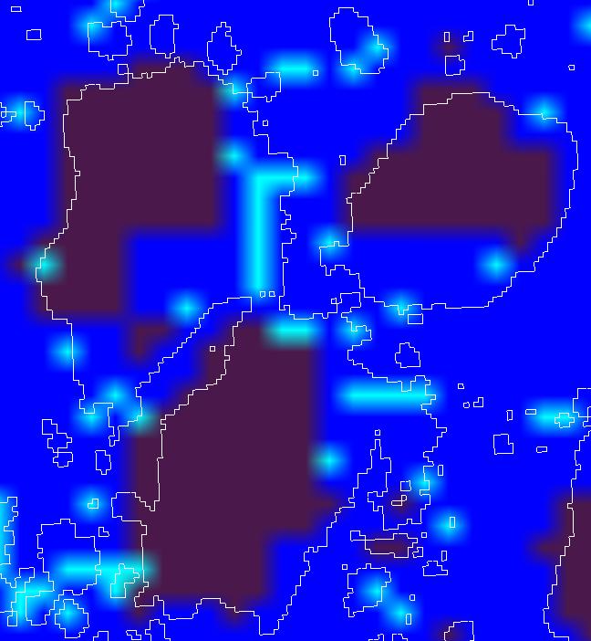

Following his advise, I install the qgis,and the grass plugin and create new location(epsg4326),and reproj my vector map to this proj,then export it to kml successfully,however when add the kml to googlearth I found the layer doesnot match the tiff,the annex can give a clear explaination.
The reason I export the map to kml and add it to googlearth is to make a thecmatic map by their areas(I have five vector maps),also I found the d.vect.thecmatic is to make this kind of map ,however I did not sure the “column” parameter,I wonder this commond is useful for my goal?
