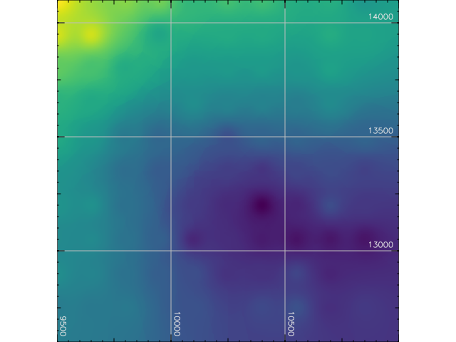

I tried with your shapefile, and got no errors. Here are the steps…
First I created a new GRASS location matching the CRS of the shapefile:
grass -c Coal-Test-Shapefile-main/coal_test.shp /home/micha/GIS/grass/michaela
Check the projection:
g.proj -p
-PROJ_INFO-------------------------------------------------
name : RD/83 / 3-degree Gauss-Kruger zone 5
ellps : bessel
proj : tmerc
lat_0 : 0
lon_0 : 15
k : 1
x_0 : 5500000
y_0 : 0
no_defs : defined
-PROJ_EPSG-------------------------------------------------
epsg : 3399
-PROJ_UNITS------------------------------------------------
unit : meter
units : meters
meters : 1
Then I imported your shapefile, and set the computational region:
v.import Coal-Test-Shapefile-main/coal_test.shp output=coal_test
g.region -ap vect=coal_test # Resolution is 1 meter, 1500x1500 pixels
Now run the IDW module
v.surf.idw input=coal colu=dbl_1 out=coal_idw_1
81 points loaded
Interpolating raster map <coal_idw_1> (1500 rows, 1500 columns)…
100%
v.surf.idw complete.
Resulting image is attached. You can try other options to v.surf.idw to get a smoother interpolation, if necessary.
HTH
