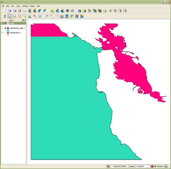

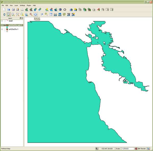

I’m having an issue with v.to.rast when converting a SRTM water body database (SWBD) shapefile to a raster. I’ve imported the file using v.in.ogr with no problems, but when I do v.to.rast, it only converts a portion of the largest polygon. I’ve attached screenshots from QGIS, one of the source vector and another with the output raster layered on top. As you can see, it’s not a region issue and there is no mask present. The region is set to the extent and resolution of the SRTM tile for that area.
command:
v.to.rast input=w123n37n_sub output=test2 use=val
The “_sub” suffix is because I filtered the original file where FACC_code = BA040. I’ve tried doing the filtering with ogr2ogr beforehand and importing the subset, as well as importing the full shapefile and using v.extract. The end raster was the same.
command:
