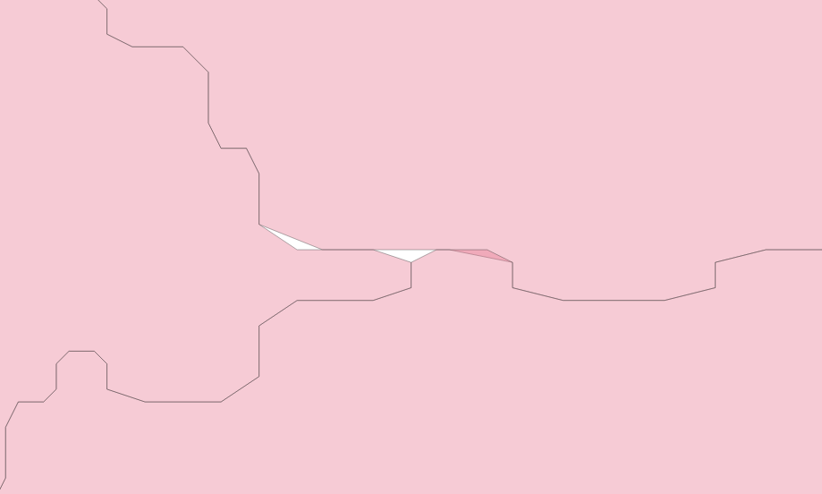

I performed a raster segmentation from a Spot6 satellite image with OTB. I polygonized/vectorized this raster segmentation in order to get a vector file. To limit the pixelation of this cover, I was thinking of smoothing the layer with the QGIS tool. This works, but the problem is that it generates topology/geometry issues (overlap, holes, etc.). And I can’t afford to have invalid geometries. Could you share some advices? Guidances in order to skip those problems? I’ve attached a screenshot of the smoothed vector segmentation.

Did you try the grass smoothing tool, v.generalize?
You may consider to vectorize it in GRASS directly, then no such problems as GRASS is a topological GIS.
Otherwise, there are topology cleaning tools, see:
https://grasswiki.osgeo.org/wiki/Vector_topology_cleaning
