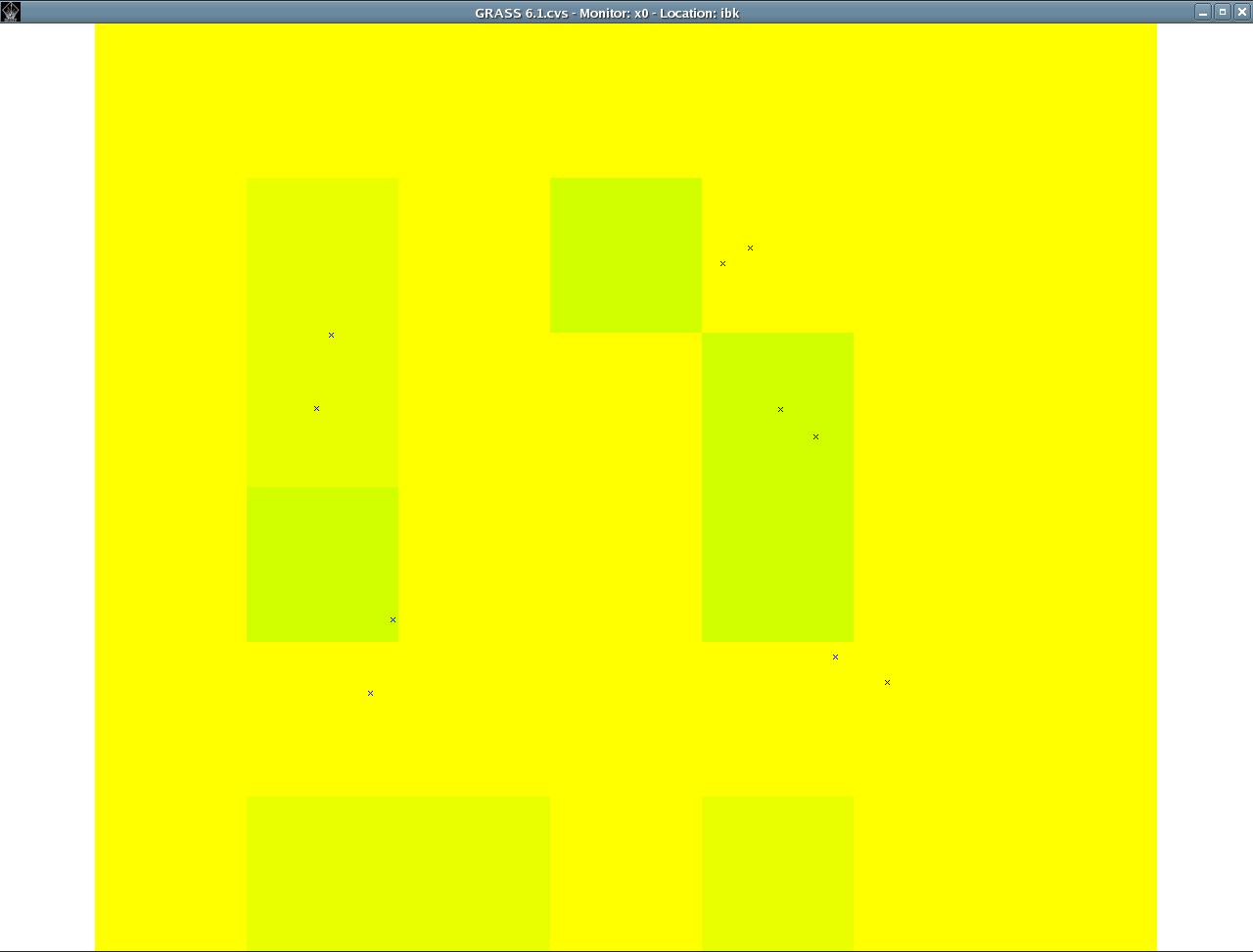

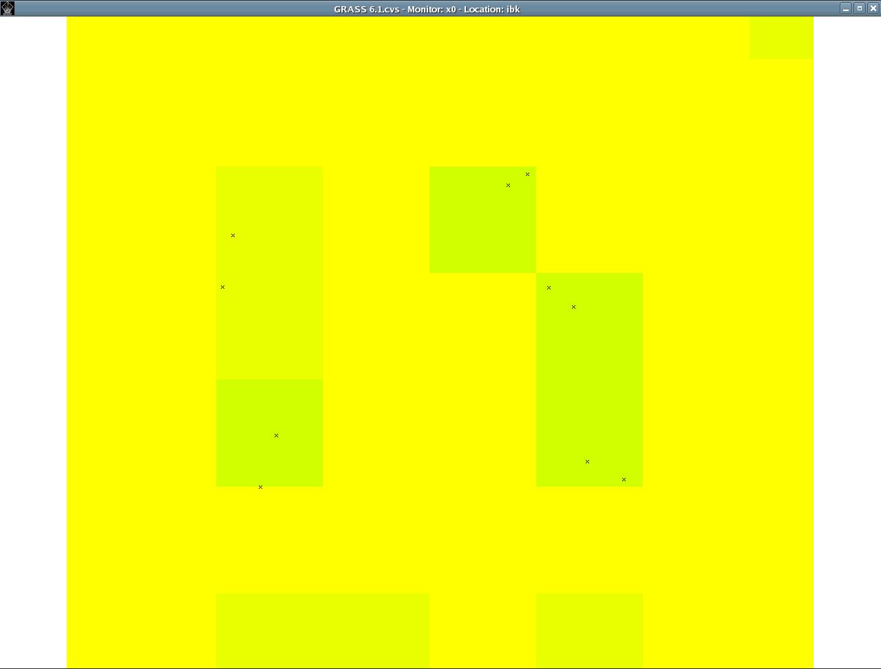

(2) Point vector display accuracy
Is it a bug or a feature that the position of point vectors varies with
the region resolution? Are the coordinates for display rounded in respect of
the current resolution setting?
The attached screenshots show 1m resolution (vector_display_error1.jpg) and
0.1m resolution vector_display_error2.jpg. The points should lie in the green
pixels which they do with 0.1m resolution. The raster resolution is 1m.
with the region resolution? Are the coordinates for display rounded
in respect of the current resolution setting?
(vector_display_error1.jpg) and 0.1m resolution
vector_display_error2.jpg. The points should lie in the green pixels
Vectors are always displayed accurately according to my experience. I
expect the trouble maker is your raster layer. Depending on raster
resolution and extents the raster might be resampled during display so
that it looks different in different region settings, and this cannot
be avoided. Post the r.info output and the current region for both
cases (g.region -p).
