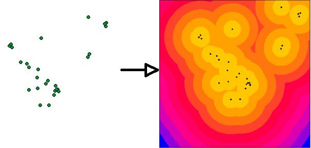

Hi everyone,
I have tested v.buffer but i can’t get several buffers, just only one. I attach an image that show you what i need.
Thanks a lot.

hi,
just try r.buffer && r.to.vect
jachym

Or,
try r.cost with a constant cost function
i.e. in the spearfish sample dataset:
#make a raster with constant value
r.plane name=const elevation=1 type=int easting=593786.1875
northing=4919369.0625
#calculate distance from bugsites
r.cost -k in=const out=bugsites_dist start_points=bugsites
#quantize as required
r.reclass ....
see attached
