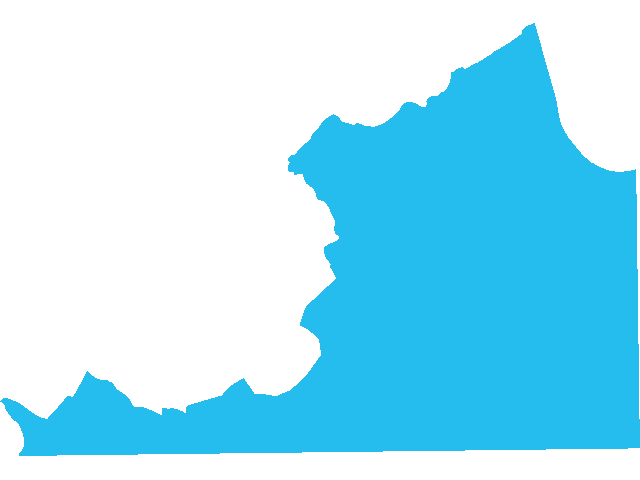

Hey Ian,
thank you for the suggestion.
I used that command between g.copy V_rast,MASK and r.mapcalc MAP_crop=MAP but that did not change anything.
Have I been supposed to use it that way? I don't work much with GRASS but the command looks like it is about making sure that just pixel that contain information are taken to create the mask. Is that right?
As it did not work out I looked at the MASK after your command and it looked like this: see mask_2.gif - the result of r.mapcalc MAP_crop=MAP looks also that way. Without your command, the MASK looks like: mask.gif - this it the way the mask has to look. This outline should become the new border for the cropped map.
I hope the pictures make things a little easier to understand.

Hey Ian,
Regards
Axel
sorry, forgot the pictures
<mask_2.gif><mask.gif>

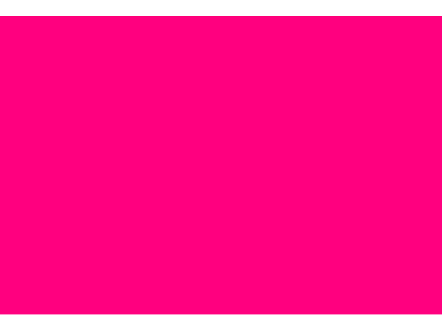

Hey,
I am using GRASS 6.1.cvs running on windows xp via cygwin. I think I got it from https://www.geographie.uni-freiburg.de/~mlechner/CygwinGRASS/
I used your new command instead of my original r.mapcalc and the result was as follows:
MAP_crop: see MAP_crop.gif
So the new command did not change anything.
I need the cropped map outside of GRASS so I can just export the map while the MASK is still there and get a fitting result. But it would be better if the problem can be solved.
Regards
Axel
<MAP_crop.gif>

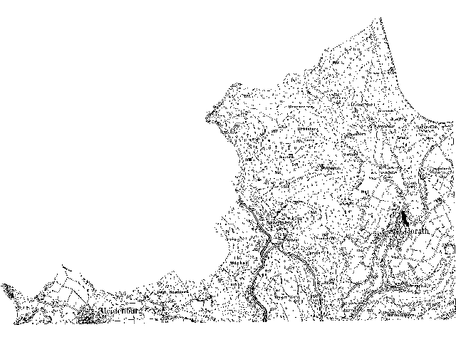

I have to admit that I did not understand the problem when I posted the first question.
But due to the discussion things are more clear now.
I want a map that looks like: intended.gif
I have a rectangular map and the mask to crop it to look that way.
When I display the map and the mask is active, I get the result you see in the attachment. I am also able to export it. Everything is fine.
BUT
I think r.mapcalc cropped_map=map should give me that result as a new raster file and when I use that command the map becomes pink.
SO it is not such a big problem but still a little bit strange.
Regards
Axel

On Thu, 16 Jun 2005 08:53:18 +0200
Idea: r.mapcalc doesn't copy the color map along with the data.
Does the range of data etc shown with r.info look consistent?
How about r.univar?
Try this to copy the color map from the original to the new after
r.mapcalc:
r.colors cropped_map rast=map
Hamish
