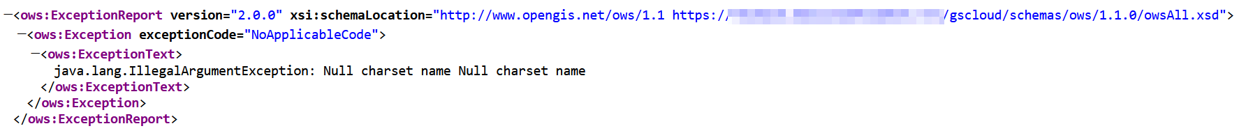

Hello everyone,

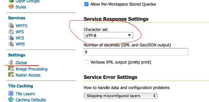

I have a “testing instance” of Geoserver Cloud deployed on K8s. While working on automating configuration settings using the REST-API I think I have messed up some config settings as I am suddenly getting an java.lang.IllegalArgumentException: Null charset name on the WFS service.
While not exactly the same it seems vaguely related to this issue where a faulty settings configuration seemed to be the cause.
Is there any simple way to reset all the pgconfig settings to start over with a vanilla instance?
Any help is appreciated!

Error-details:
Stacktrace
2026-01-13 11:43:05.924 ERROR 1 — [nio-8080-exec-1] org.geoserver.ows :
at java.base/java.nio.charset.Charset.lookup(Unknown Source)

Hi,
The stack trace is referring to this line of code:
    capsTransformer.setEncoding(
            Charset.forName(wfs.getGeoServer().getSettings().getCharset()));
Here it could certainly been a test for null to avoid the NullPointerException you experience. What should have been returned from getCharset() is the content of the following field in the user interface.
You could start by changing this to see if that has some effect.
Best regards,
Roar Brænden
Hi Roar,
many thanks for looking into it! Indeed that was the faulty setting, although I cannot trace back how this has been changed from the default and how i missed that setting during my searches for the cause. :roll_eyes:
Instead of testing for null in your mentioned code block it would probably be even better to just fallback to UTF-8 which is the default mentioned in the docs and “which is recommended for most users” anyway.
Service response settings
Character set
Specifies the global character encoding that will be used in XML responses. Default is UTF-8, which is recommended for most users. A full list of supported character sets is available on the IANA Charset Registry.
Cheers,
Lars
