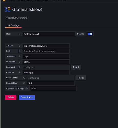

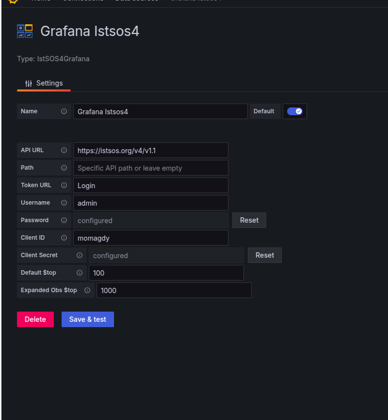

1. Configuration Interface
I developed a configuration interface to set up your server, authentication credentials, and default pagination fallback values for entities and expanded observation entity that will be used when no $Top values are specified.

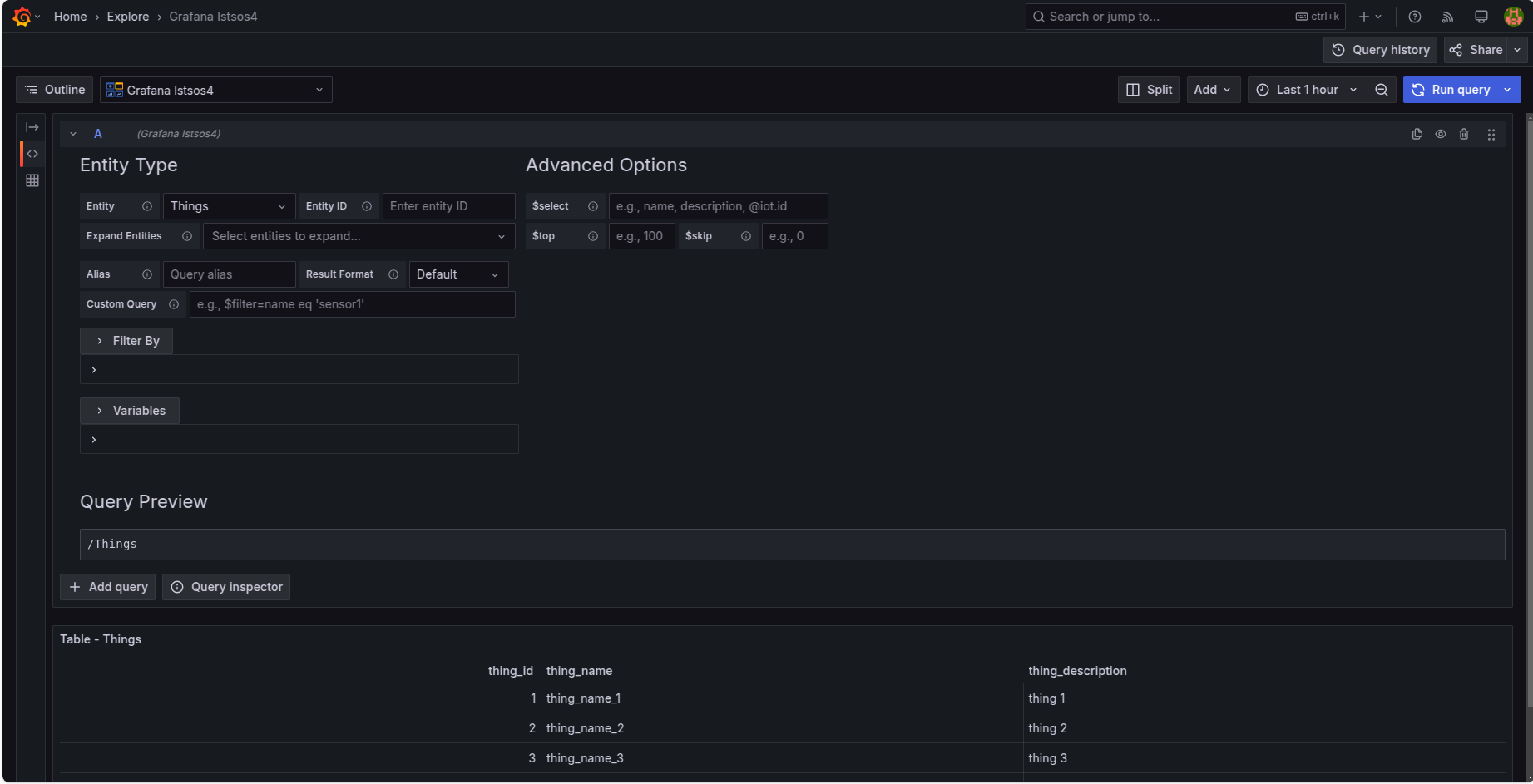

2. Query Editor Interface
I created a query editor interface to configure most of the standard specifications including:
  • Filter
  • Expand
  • Select
  • Top
  • Skip
  • Entity ID
  • A text area for writing fully customized queries
Filtering Framework
The following types of filters are currently supported:
  • Basic filters: Common fields like IDs, names, and descriptions for almost all entities except observations (observations do not contain specific names or descriptions)
  • Temporal filters: Filter the phenomenon time and result time for datastreams
  • Spatial filters: Intersect and within geometric queries such as Point, Polygon, and LineString for locations and datastream observed areas
  • Measurement filters: Sensor-specific data filtering like unit and symbol measurements for datastream unit of measurement
  • Observation filters: Result, phenomenon time, and result time for observation entity
  • Entity filters: Manage relationships between entities (e.g., select datastreams based on specific sensors, things, and observed properties)
Expand options are customized based on the selected entity, which can be found in the constants.ts file. You have the option to write fully customized and complex filters using the customized option.

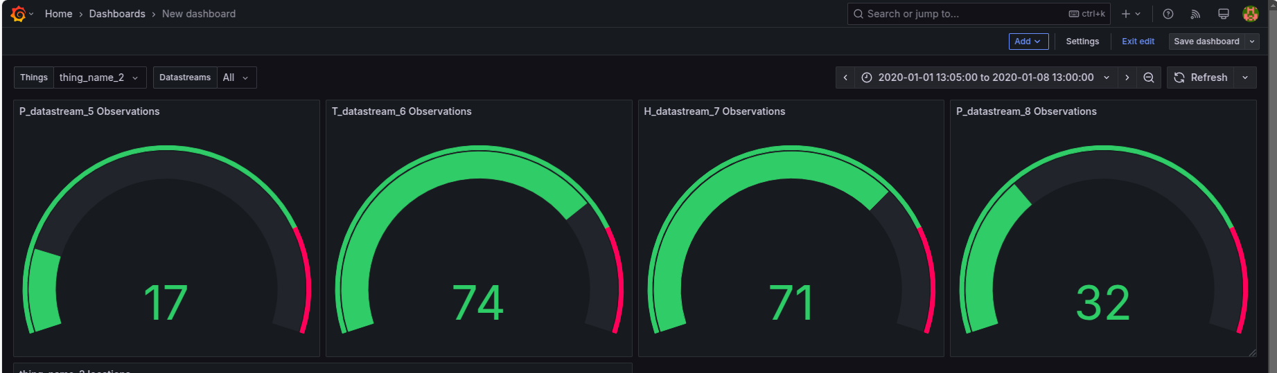

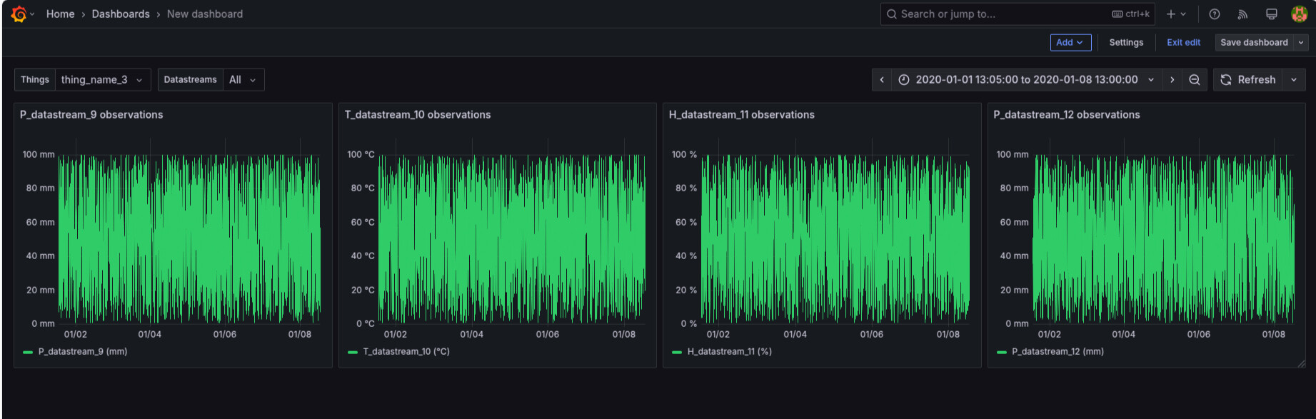

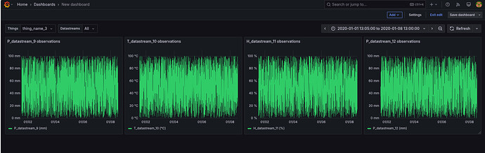

Using the implemented features, you can create:
Dynamic Panels & Dashboards
The ability to create panels and dashboards to visualize:
  • Datastream observations: Time-series data visualization
  • Locations and historical locations of things: Using orchestracities-map-panel that supports complex geometry visualizations
