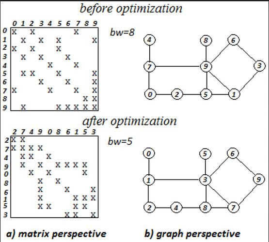

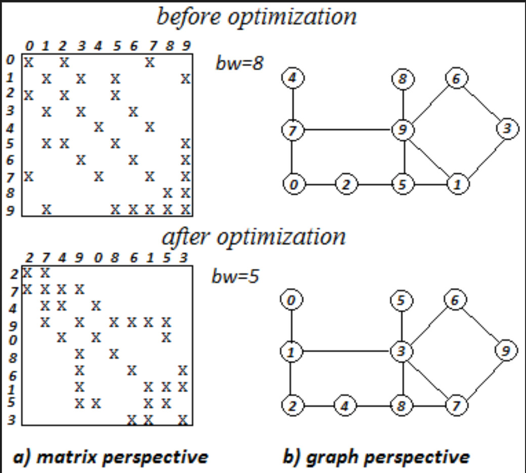

Hello @cvvergara , @robe
I have used the following graph as examples to add in the documentation , but I am getting the same bandwidth for both the graphs and that is 6 even though the connections are different .
Can you once check why is this happening ?
I have added both the examples in additional examples section in my documentation so you can check through that .

@bipashabg @Saloni-2005
Can you try the following code:
#if 0
        UndirectedGraph undigraph;
#else
        auto vertices(pgrouting::extract_vertices(edges));
        UndirectedGraph undigraph(vertices);
#endif
log << undigraph
That will:
  • Insert the vertices in order of id
    • The vertex descriptors will be given in increasing order of the vertex id
  • Insert the edges
  • print the graph, (you will need to used the DEBUG3 option when running docqueries)
If you set the if to 1: (the way its working now)
  • Insert the edges
    • vertices descriptors are assigned in first come first served order
We already tested with king ordering with @wifi
As you are awake at the same time, maybe he can explain to you.
