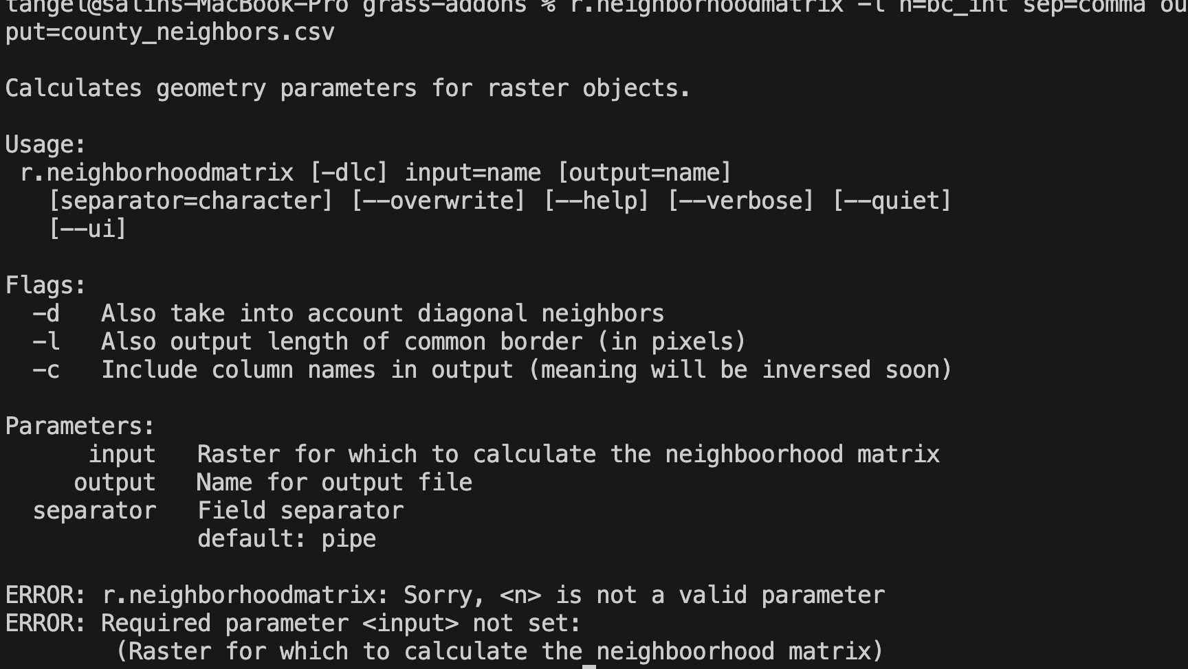

Hi Anna, I was reading the r.neighborhoodmatrix manual page. “ r.neighborhoodmatrix - GRASS GIS manual
While running my first test, I realized that the example command provided is not working.
The current version is: r.neighborhoodmatrix -l n=bc_int sep=comma output=county_neighbors.csv
I changed n=bc_int to in=bc_int and it worked! If this is a mistake in the documentation, I would be happy to fix the web page. Let me know what you think! Thank you.
Definitely a mistake in the documentation. This example command is just an extension of the previous one, where input is in=. Any abbreviation of a parameter has to contain the beginning of that parameter name.
