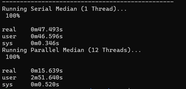

I noticed that r.resamp.stats is currently single-threaded, which creates a bottleneck for large datasets.
As a proof-of-concept, I implemented an OpenMP-based parallel version locally. By optimizing the memory allocation strategy (removing internal G_malloc locks during parallel regions), I achieved a 3x speedup on a Median calculation benchmark (30k x 30k pixel map).
Benchmark Results (Median Method):
  • Serial: 47.49s
  • Parallel (12 Threads): 15.64s
I would like to propose a GSoC project to fully implement, test, and merge this optimization for all aggregation methods in r.resamp.stats.
Would this be a suitable project for this year’s roadmap? I would love your feedback.
Best, Vinay
Here is the screenshot of the benchmark run:
Thanks! Could you make a PR? You can open it as a draft, but we need to see your implementation, just describe any limitations of your solution. There is a benchmarking library you can use to show the speedup for different number of cores, see example in r.mapcalc tool.

Limitations: As noted in the PR description, this prototype currently only implements the average and median methods. I also bypassed G_malloc for standard malloc in the parallel regions to avoid locking, which will need a safety review.
Benchmarks: For this initial prototype, I used manual timings (screenshots attached in PR). I will look into the r.mapcalc benchmarking library next and update the PR with proper automated benchmarks as you suggested.

I recently pushed a major update to the PR, including a Python benchmarking script (following the r.neighbors pattern) to verify the results. On a Ryzen 5600H, I am seeing a 4x speedup on large datasets (200M+ cells) using the reworked OpenMP implementation.
